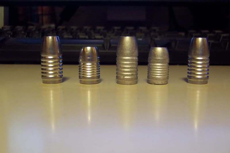

casting sessions,,,,
Learned the hard way what happens when your pouring tempo is alil fast for the mold's likes
Frosty bullets once I got the mold up to temp and past on good fillout
Asked around, and was told to slow down abit
and these look like I'm about as fast as the mold likes

Postby 870TC on Thu Oct 14, 2010 8:27 pm
A little frost is ok, it will go away when you size.

Postby onesonek on Fri Oct 15, 2010 7:08 am
870TC wrote:A little frost is ok, it will go away when you size.
I agree with that, but the exception is,,,, the frosty ones also shrunk more. So much that the they were very near or under my slug diameter. Whereas the shiney ones and with alloy od 93-5-2 were running .001 thru .0012" over slug,,,,from what I been hearing/reading that or a tad more over dia. is what is desired

Re: First and second
Postby onesonek on Fri Oct 15, 2010 7:13 am
Pat Cannon wrote:I've bought bullets that didn't look that good. In fact, most of the bullets I've bought didn't look that good!
All in all I'm very happy with the Accurate Mold, and once I figured out the toaster oven does a great job of preheating (or keeping it hot if I have a interuption) the mold to 425+ degrees,,,, my cull rate dropped sustantially. And again, getting the tempo down.

Postby selurcspi on Fri Oct 15, 2010 10:53 am
Dip the corner of the mold into the lead, that keeps it hot too!

Postby mmcnx2 on Fri Oct 15, 2010 12:05 pm
I don't cast any more but whe I did I rested the mold on a hot plate. I just adjusted the temp on the hot plate to get the temp I needed based on the mold.

Postby Seismic Sam on Sat Oct 16, 2010 8:22 pm
Best thing to do is cast with two molds (maybe the same caliber, maybe not) so you can go as fast as you can alternating molds to keep producing good bullets. The other trick is to heave another 1 pound ingot of bullet lead into the pot, and it will act like an ice cube in a drink and cool down the molten lead so it won't frost up as much in a mold that's gotten up to temperature.

Postby onesonek on Sun Oct 17, 2010 9:36 am
Seismic Sam wrote:Best thing to do is cast with two molds (maybe the same caliber, maybe not) so you can go as fast as you can alternating molds to keep producing good bullets. The other trick is to heave another 1 pound ingot of bullet lead into the pot, and it will act like an ice cube in a drink and cool down the molten lead so it won't frost up as much in a mold that's gotten up to temperature.
Yeah Sam, I plan on getting at least one more mold in a 465 gr. and do the switch routine.
As to the second part, I did that too, more as a way to use up a 1/2 dozen sprues and or 3-4 culls at the later half of the session. Didn't think it would matter much.
Now I can't say for sure what was happening,,, this is all new to me. But when I went to testing bhn of a 10 boolit lot at 48hrs after casting, I had 2 points of variation in hardness, and one that was so soft it was off the scale on the Lee tester. My own thoughts at this point are, the the cool alloy addition acted like a magnet or sponge of sorts, attacting the surrounding antimony. You think that is possible?
In my mind, that much variation has to raise cain with accuracy.
BTW, the alloy I was using there was a 1-1-1 lino, isotope, and co-ww's somewhere like a 93-5-2 with the bulk of the boolits testing about 14.5-15 bhn

Postby Seismic Sam on Sun Oct 17, 2010 1:13 pm
I must confess that you have asked a question I can't answer about the cold lead acting like a sponge. Based on scientific principles, it would be hard for me to believe that a local temperature variation could do that much to change the makeup of the bullet lead. the entropy forces to keep things mixed are quite strong, and I simply can't imagine from the statistical thermodynamics courses I took a long time ago that this is even remotely likely.
On the other hand, rapid cooling of the bullets IS a known factor in bullet hardness, so if you had a bullet that was cast with hot lead in a hot mold but still came out alright, it might be significantly softer because the lead wasn't quenched enough by the coldness of the mold. If you read the fine print in the Lee Hardness tester, they also tell you that you should not test the base of cast bullets or ingots becuase those are both air cooled and not mold cooled, and as such your hardness readings will be significantly lower.

Postby onesonek on Sun Oct 17, 2010 4:51 pm
Yeah well it has me sorta scratch'n my head and wondering.
No I didnt read that part on the Lee tester, and I did measure both the base and flat nose. And as you and they say there is a difference in the readings. But pretty much common sense dictates, to go with the number that contacts the animal first, so in this case the boolits were all tested on the flat of the meplat.
