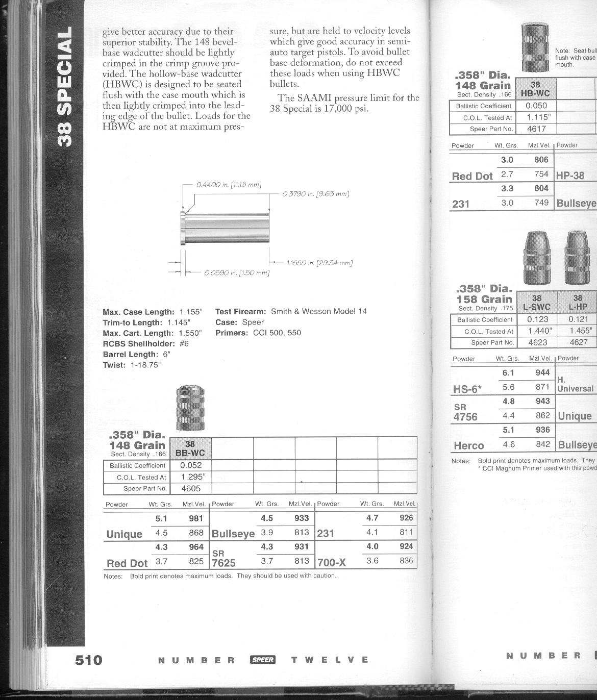

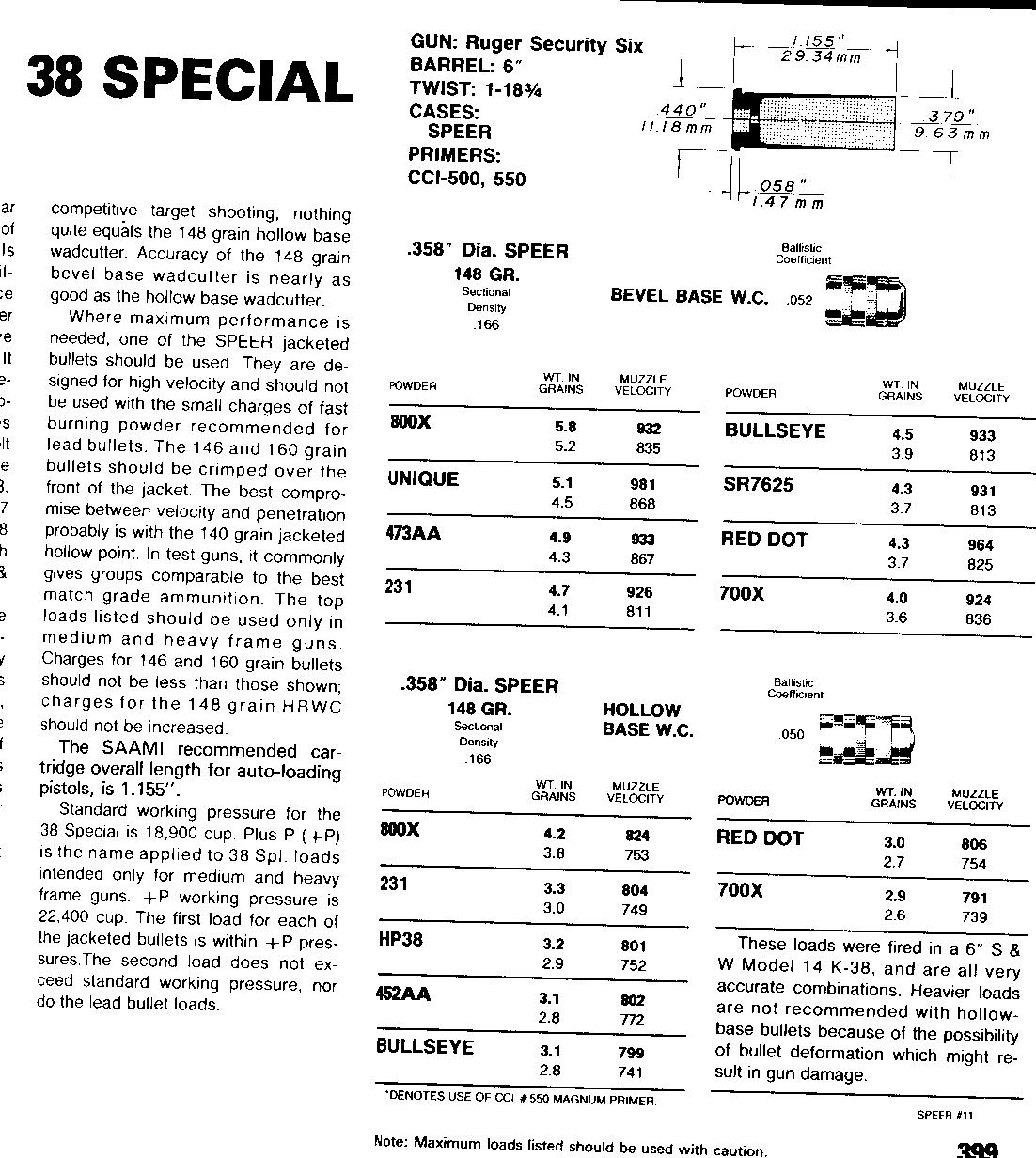

I just want to make this CLEAR, this is not substituting anything, the speer manual clearly states that cci 500, 550 primers can be used.
These are from edition 11 & 12.

Oddly enough, I had a can of 630 powder left over from the 1980's, and went through my copies of Speer manuals #8, #9, #10, #11, and #13 looking for a 9mm load that would use that powder. I did find one, but it called for the use of a magnum pistol primer with about 10 grains of 630, and I just decided to pass on the whole deal. As far as the copy of Speer manual #11 that you have posted, it indeed says up on top that CCI 500 and 550 primers are used in these loads. THAT is not the whole story, however, because if you look at the next to the last line on the page, you will see that it says: "*DENOTES THE USE OF CCI 550 MAGNUM PRIMER". The point here is that that asterisk is for SPECIFIC LOADS with CERTAIN POWDERS, and on the page you have shown, NONE of the loads listed are designed to be used with magnum primers.
If you go through all the data, you will find that there are some 2400 loads that need magnum primers, and some HS-5 and HS-6 loads also. The point here is that this manual lists some loads with regular primers and some with magnum primers, but NOWHERE does it state that they can be interchanged. Your post at least suggests that you could get away with using a magnum primer with a max load of Bullseye with one of the two bullets on that page based on the heading up top, while the fine print tells you that these loads DO NOT and SHOULD NOT use magnum primers.

What's strange is that Speer 13 lists the same primers (CCI 500 and 550) for 38 Special, but there are no asterisks next to any of the loads denoting the use of magnum primers. In fact, I just checked again to make sure. I see the HS-6 load on the first scan you posted has an asterisk. HS-6 seems to have disappeared from the 38 Special load data in Speer 13. It is, however, listed for use with some of the +P loads, but with no asterisks. Speer = sloppy. I need another reloading manual quick!

macphisto wrote:What's strange is that Speer 13 lists the same primers (CCI 500 and 550) for 38 Special, but there are no asterisks next to any of the loads denoting the use of magnum primers. In fact, I just checked again to make sure. I see the HS-6 load on the first scan you posted has an asterisk. HS-6 seems to have disappeared from the 38 Special load data in Speer 13. It is, however, listed for use with some of the +P loads, but with no asterisks. Speer = sloppy. I need another reloading manual quick!
Welcome to the wonderful world of reloading. You read one thing wrong, and you can blow your ass clean off. That's why it pays to have 5, or 10, or more reloading manuals, and read them religiously from cover to cover, and then start noticing the differences between them. In addition, you should start memorizing what the normal primer is for the calibers you use. Magnum primers for the 38 Special? Yup, they were a rarity, and now they're unheard of. Their fault was not with the previous editions, but the 13th and 14th, where they left the two recommendations but no data for magnum primers. When I first found a 630 powder listing for the 9mm I was very happy, but I DID read the fine print and I wanted no part of a handload with a slow burning powder and a magnum primer in 9mm. With max loads maybe it will burn consistently, but why take the chance?? (And that's the ONLY reason you need a magnum primer to begin with...) Would any of you old farts with a Speer #8 or #9 manual want a free pound of 630 powder??

Seismic Sam wrote:Oddly enough, I had a can of 630 powder left over from the 1980's, and went through my copies of Speer manuals #8, #9, #10, #11, and #13 looking for a 9mm load that would use that powder. I did find one, but it called for the use of a magnum pistol primer with about 10 grains of 630, and I just decided to pass on the whole deal. As far as the copy of Speer manual #11 that you have posted, it indeed says up on top that CCI 500 and 550 primers are used in these loads. THAT is not the whole story, however, because if you look at the next to the last line on the page, you will see that it says: "*DENOTES THE USE OF CCI 550 MAGNUM PRIMER". The point here is that that asterisk is for SPECIFIC LOADS with CERTAIN POWDERS, and on the page you have shown, NONE of the loads listed are designed to be used with magnum primers.
I went to school a very long time ago but when I read that page it tells me that you may SAFELY use EITHER 500 or 550 primers and then it goes on to state that with these (*) particular loads it is denoted that you must use the 550 primers. The following page has many loads denoting with the *. No where in the manual does it state DO NOT and SHOULD NOT use magnum primers.

You realize what you have just done?? You just went public and said that in your learned opinion, the Speer manual says that you can safely interchange regular and magnum primers with ANY load where two primers listed. You do realize that if one of the many newbies in here takes your advice and gets injured, then it's on your head, and you may be liable in court for the injuries you have caused?? The word "must" does not appear in the asterisk statement. That's your addition. It says magnum primers were used with those loads, period.
And as far as the manual NOT saying aything about the use of magnum primers, onviously you didn't read page 27, which under the section on primers it says " Magnum primers may be used with faster burning or easy-to-ignite powders , but normally there is no advantage in doing so. As when changing other components, it is advisable to reduce powder charge weights on initial loading with magnum primers."
So, the manual says there's no advantage with faster powders, so it's a reasonable assumption that in the Speer #11 manual, they didn't use mangum primers unless they had a specific reason to do so. That also means that in the loads withOUT asterisks, those loads were developed with regular primers, and NOT magnum primers. IN addition, it cautions that you need to reduce powder weight when switching from regular primers to magnum primers. Gee, the manual says you better watch your ass when switching primers, but you say in your highly educated opinion of interpreting the English language that it's safe to do. Just swap in a magnum primer with a maximum charge of Bullseye, and the way you read it, you'll be fine. Like I said, if somebody gets hurt following your advice, then it's on your head and your conscience.
