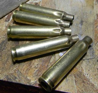

I've used Imperial wax for years and the only complaint I have is it's putzie to apply.
A friend told me he uses Pam cooking spray, the original with Conola oil.
As an experiment, I put 100 223 cases into a ziplock bag, gave it a shot of Pam, sealed it and mixed the cases up in the bag. The cases resized effortlessly. Unfortunately, I must have gave the bag too big of a shot and over lubed the cases as every one dented. (see pict)

Postby Seismic Sam on Tue Apr 26, 2011 2:15 am
Re case dents: That is the beauty of Imperial die wax. you use so little that the lube can never get trapped in the die between the base and the neck and buid up to collapse the case wall and cause dents like that, which is one of the major drawbacks of reforming or resizing bottle necked cases, both rifle and pistol. And I hate to say it, but with case dents like that the brass is scrap, because one part of the case has been overworked, and while you can blow it back out again by shooting it, that part of the case has seen more stress than the rest of it.
