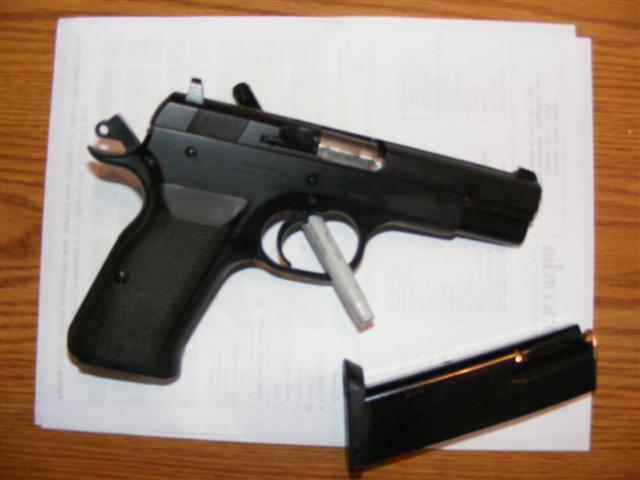

Heres a pic om mine I've had it 11or 12 years now with wonder finish I also have the 9mm conversion for it and it is an absolute pleasure to shoot with 9mm and the heavy frame and accurate. I had the usual fail to feed and replaced the mag spring and the recoil spring with heaver springs and polished the feed ramp and removed the sharp edge on the chamber so fail to feed are only once in a great while with the 10mm but the 9mm feeds without problem at all. I mostly shoot hornady 180gr hp/xtp with 10.5gr of aa7 it gives me around 1120fps for the 10mm. I even took a deer with it at about 22yds neck shot.
