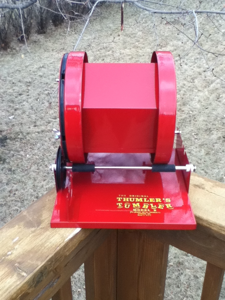

Look what arrived only moments ago.
I'm in business.

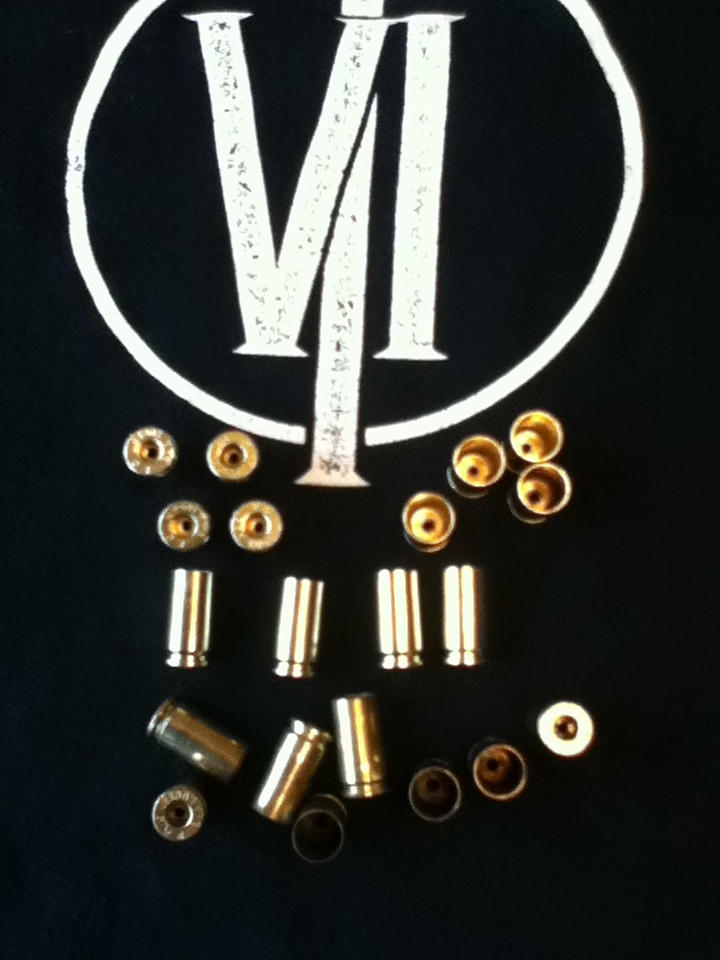

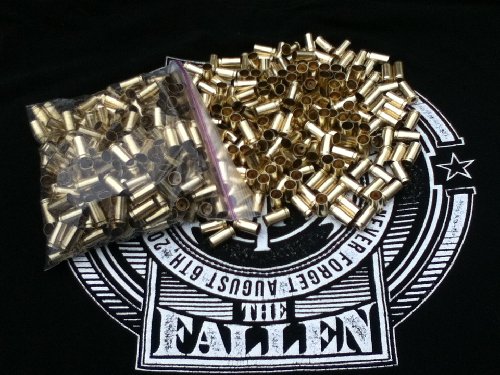

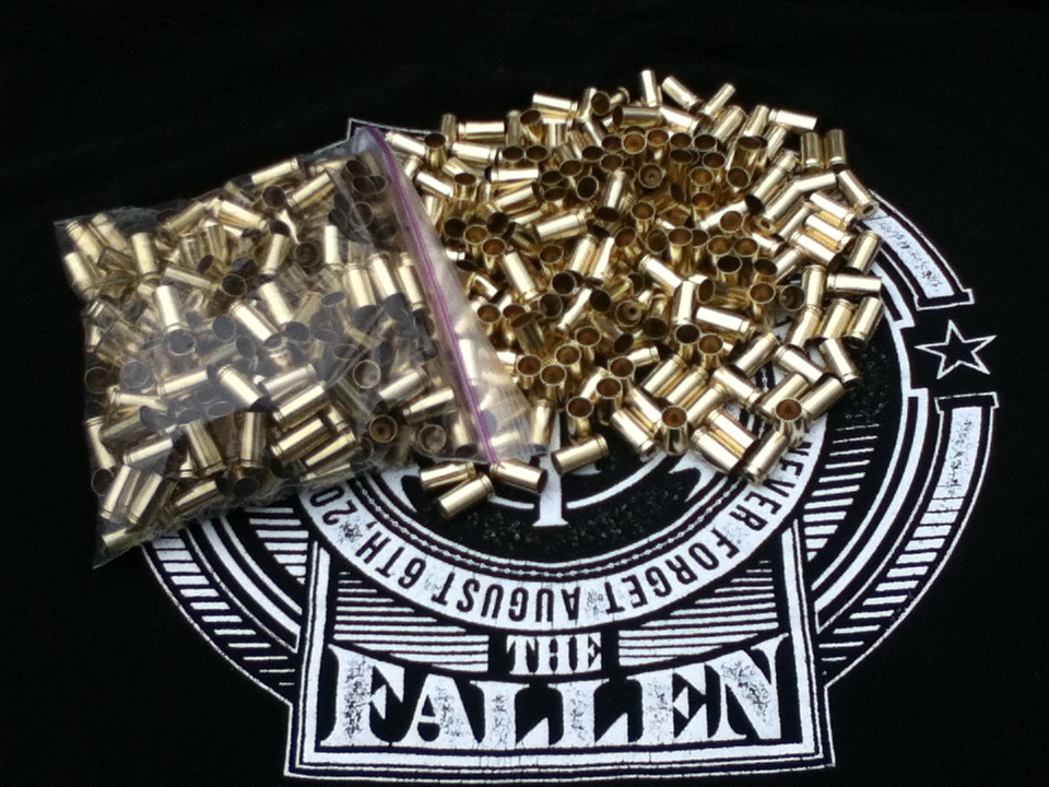

Postby Mjollnir on Tue Mar 20, 2012 1:23 pm
The first picture is of about 440 cases of 9mm, (two batches) after tumbling.
The second picture is of 12 cases of 9mm after tumbling, and some below before tumbling. Notice the clean primer pockets.
