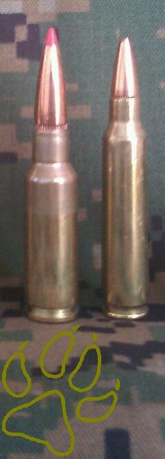

Here is one of the offending children next to a factory .223
I'm out of town, so it's all I have for reference pics of the loads.
Most of the detailed attention was directed to perfecting the powder load consitency and the primer seating.
The OAL fits a magazine. Not much free room to move, but they fit. I didn't like how they look, but was told "they should be fine" since they did go into a magazine. I trusted an experienced handloader, to my now-apparent error.
The problem came to light when trying to clear a loaded round from the rifle's chamber.
Again, these were loaded about 2 years ago when there wasn't anything for factory load offerings other than Alexander Arms' loads. This was JUST before Hornady started offering their initial load (which I have a small supply of now). The guy offered me brass, powder and primers as payment of sorts. All I had to provide was the projectiles. So, 100 rounds of Grendel ammo for about $25 was a bit hard to pass up at the time.
I researched potential loads which had worked for others in similar rifles. I didn't need anything worty of Camp Perry, just Minute of Whitetail 20-200 yards. As they sit, they're sub-MOA (but a PITA to clear a loaded round from the chamber, which doesn't lend itself too well if nothing passes my tree-stand that particular day). I clearly want them un-f****d.

Postby Seismic Sam on Fri Mar 23, 2012 9:16 am
Thank you. The fitting in the mag part is "sort of" an OAL measurement, but obviously it didn't work in this case. Only two things come to mind, and the first is that the gun you have has an extremely short throat. Perhaps so short that it's a machining mistake by the factory. I am not a fan of Alexander Arms, as they are the originator of the 50 Beowulf cartridge and upper which had all sorts of problems, including full case head collapses and reportedly some blown bolts.
http://www.mnguntalk.com/viewtopic.php?f=52&t=17845&p=196424&hilit=+beowulf#p196424
I am sure the 6.5 Grendel is fine as a cartridge, but that still leaves the question of whether Alexander Arms gave you a rifle with a (too?) short throat.
Looking at the case you loaded, I notice there appears to be a lot of cannelure above the crimp, so I am wondering if you crimped the case at the top of the cannelure, whether the extra 30 - 50 mils might be enough to get the bullet off the lands. As far as disassembling the rounds, go get a blue (or green?) clear plastic inertia bullet puller for $16.95 or so, and pull all the bullets. The puller has a foam pad at the bottom of the hammer head, so you can re-use the bullets no problem.
At this point, I think you need to get a clear answer as to how long a round your upper will tolerate, and to do this follow the directions by OldmanFCSA in this thread:
http://www.mnguntalk.com/viewtopic.php?f=12&t=29314&p=334206&hilit=cleaning+rod#p334206
My Hornady #8 Manual shows that all Hornady bullets reccomended for the 6.5 have a COL of 2.245" inches. If you find out that your upper won't accept a loaded round that is 2.245" from base to bullet tip, then the upper is defective and needs to be sent back to Alexander. Hopefully that won't be the case, but the fact that the loaded rounds fit in the mag could be a warning sign.
Good luck, and let us know how it turns out!
