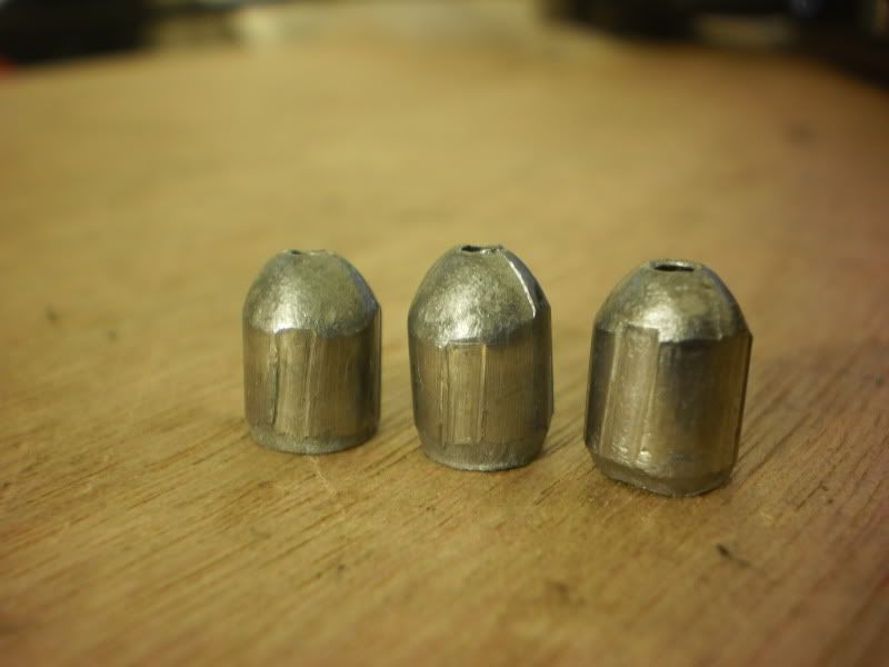

Sluging a barrel is pretty simple. You take a soft lead "slug" that is slightly ( a few thou) larger than your bore. Push it through the barrel so that the lead slug forms itself to the lands and grooves of your particular barrel.
As far as what to use as a slug? Soft lead works best. Some folks use fishing lures, other folks buy specially made lead slugs, others make their own. I've heard of folks melting lead into a fired case, then removing the brass jacket. in straight walled pistol cartridges you can use the whole slug, or cut it down. In necked cartridges just use the portion that fills the neck area of the case.
Either way, grease up the slug with sizing wax or some other gun friendly lubricant and use a wooden dowel to drive the slug through the barrel from breach to muzzle. Measure from groove to groove, (biggest diameter portion of the slug) not land to land and you will have the measurement for the correct sized bullet. For .45 ACP it will generally be somewhere between .451 to .454.
Hope this helps! If not, there are several articles on the intrawebz, and many youtube videos out there to help you.
Cross section of a barrel with nominclature.
Fishing weights folks tend to use....
What they look like after the barrel is slugged.
Also, this setp is not terribly necessary for normal applications wih modern firearms. You can use .451 or .452 no problem with your .45 ACP. If you are looking to roll your own ammo for the purposes of accuracy, or loading for an antique, or surplus firearm your best potential is with using the correct bullet diameter.
