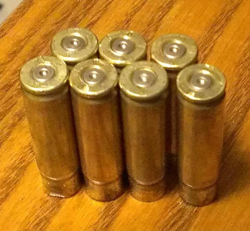

Well, I got to the range today with a couple test loads (no way to chrono there, so I didn't get numbers) and had excellent results with 150gr moly SMK's over 17gr of H110, and some pressure signs (extractor swipe, flattened primers) with Nosler Ballistic Tips of the same weight and same charge. I was expecting the moly to keep the pressure down, but I was surprised the Nosler's had as much brass flow as they did. The Noslers were also substantially less accurate, even after a few rounds to work the moly out. I'm going to load another string of them up and drop it back .5gr and see if that helps reign them in.
I was mainly just doing a function check and sighting in the scope. Now that I know it goes bang, and will be somewhere on paper at 100yds I'll be more interested in cooking up some better loads.
Not the greatest pic, but here's a few of the cases.
