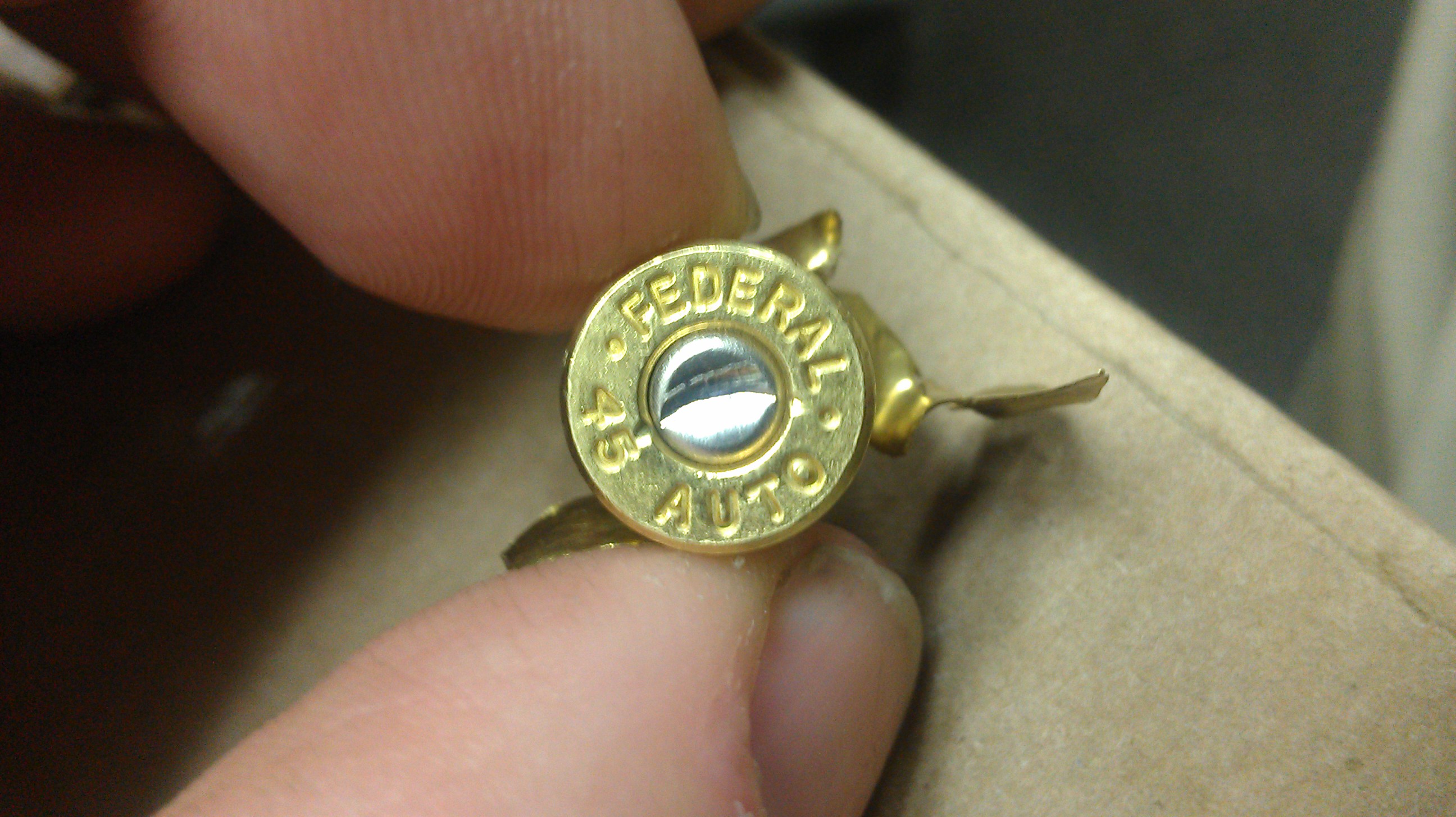

So, just a word of warning to those who have bulk boxes of .45 ACP. The rim on a .45 ACP cartridge is just the right size to cause ignition of the primer on another .45 ACP cartridge...with nasty results should it happen while you're in the general vicinity. This is a round from a bulk box of .45ACP that someone dropped approximately 4ft onto a hard floor. That person heard a loud BANG. After changing their shorts, they found this in the box.
IMHO, leave it in trays or compartmentalized ammo boxes.

I would guess that .45CP bulk (loose) packs will be going away, if not gone already. In a nutshell, the transportation regulations for ORM-D Ammo are going away, and whats replacing them doesn't allow for anything bulk packed except .22LR.
Loose, oriented rounds are allowed - aligned primer to primer...but they have to be setup and packaged so that stuff like this doesn't happen.

I've actually seen many rounds like the one in the photo. From my experience the half moon/crescent shape is present when the round comes off the progressive press. (have not seen it in bulk packing but it certainly could happen).
Sometimes its caused by debris getting under the new primer as it is seated, and sometimes its from a hesitation in the primer deliver system.....good reason to keep your press clean.

870TC wrote:I've actually seen many rounds like the one in the photo. From my experience the half moon/crescent shape is present when the round comes off the progressive press. (have not seen it in bulk packing but it certainly could happen).
If I get a chance with the round again I'll take a picture with it and another .45ACP case -- the half-moon crease matches perfectly. Plus, this was a box of factory ammo, it didn't come out of a press like this.

Every box of WWB bulk pack of .45 ACP that I've ever purchased has them aligned similar to what photogpat mentioned, except they're aligned nose to nose instead of primer to primer.
PS - my understanding is that Federal primers are considered the softest of all the major manufacturers

That round would not have even made it through a piece of sheetrock. Check out the SAMMI video test on youtube for yourself. Hell an unsupported 30-06 will bounce of of a piece of sheetrock.

Seen the video - I'm still going to say I wouldn't want it happening right in front of me without eye protection though.

Problem is the shrapnel, can damage and detonate other rounds in the pacakge/box/container. I watched someone drop a Dillon box of 100 on the floor, one went off and 3 were damaged enough to possibly cause a chain reaction.

Small arms ammo doesn't propagate, ie. one round won't set off the round next to it. Shrapnel is a problem to the eyes and skin though! :shock:
Loose primers are a different story, they propagate easily...

It would not cause a chain reaction. watch the video that lights refers too. They do a lot of different tests, rounds do not set off other rounds.
