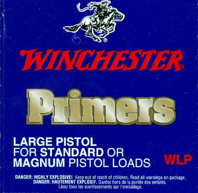

SIGP240 wrote:For a year or more, Winchester small pistol Primers were marked For both mag and regular.
I know this was the case for Large Pistol, how long ago was it that way for small pistol?

Postby arizona98tj on Sun May 19, 2013 4:39 pm
I just looked at the Winchester SPP boxes I bought back in May 2008....the are NOT marked as regular and magnum primers. That is the most current box of Winester SPP I have.

Re: Small Pistol vs. Small Magnum Pistol Primers
Postby liferefugee on Mon May 20, 2013 1:17 pm
The brand new winchester spp boxes I have say for standard pistol loads.
Postby Rip Van Winkle on Mon May 20, 2013 9:28 pm
This is what the last Winchester LP primers I used said.
