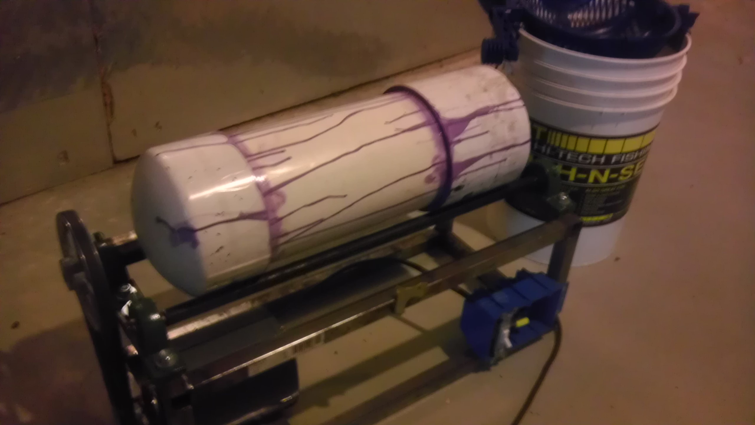

Why not make your own I have less than $150 into mine and I can do about 500 .223 at a time. Holds a little more than three gallons of water. (Ignore my pvc primer craziness :shock: )
5 gallon pail for reference
