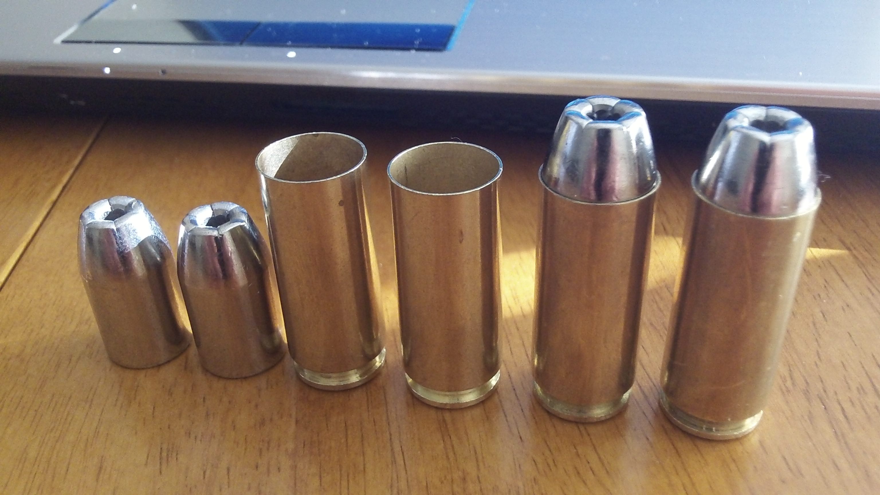

I have tons of Winchester platinum tip 400 grain that I would like to load. I know it can be done but I have no load data for this bullet or weight and cannot find any online. Tyrone Umlauf whom owns Shooting Sports in Little Falls has some .50AE customers who shoot these 400 grains with great results and they have load data but he has been unable to get me any so far. Being I'm new to this game I'm not going to work a load when I have only data for 350 grain in a similar type of hollowpoint bullet, as my main concern starting out is safety.
I have my rcbs dies all setup on my lee classic 4 turret, de-primer/re-sizer--belling--and two taper seater/crimp dies one to seat and the second to crimp. I only ran two dummy rounds through(no primer or powder) to test out dies and do basic settings, no real clue what my OAL needs to be with this size of bullet or what amount of H110 I need to start with.
Just want to get overall advice whether detailed or not about the procedure to work a load without having the exact load info for this bullet and weight.
Winchester platinum tip 400 grain:
0.901 length 0.501 diameter
Starline Brass:
1.281 case length 0.539 outside base diameter 0.495 inside mouth diameter 0.522 outside mouth diameter
Two loaded rounds OAL is 1.587(not accounting for amount of powder I will need). Both rounds cycle through both my Mark XIX DE .50s well. The crimp made the outside mouth diameter on both rounds almost unnoticeably different, maybe .0005 smaller but I'm not sure if basic calipers is the best way to check proper crimp or if there even is a good way other than visual.

First thing is you're completely off base on the taper crimp. For a stiff 50AE load its FIVE FULL MILS!! 500 Smith is 7 mils. The best way to measure is pull the bullet and measure the crimp groove diameter left on the bullet. You want .495" diameter in the crimp groove.
BTW: How long you been loading 50AE, and how many other calibers you load?
As far as figuring out a load, closest data is Hornady #9, for the Smith 500, with 300, 350 and 500 grain bullets. Create an X-Y plot of bullet weight on the X axis versus the STARTING load for 296 powder on the Y axis for all 3 bullets. Then draw in a point at 400 grains to give you a calculated powder weight for that bullet.
After that, you have to scale the graph down proportionally for all the points so that the powder weight for the 300 grain bullet is 32.5 grains, which is the correct load for the 50AE with that bullet. You can then calculate how much less powder you will need for a 400 grain bullet. Reduce that by 10% and start working up loads, and keep track of the primer signs. If you start getting a mark on the case head from the cutout on the bolt face for the extractor, you are at the top end of the load. Attempting this without a chrono is probably not a good idea.
This is pretty straightforward math, so you should be able to do it.

Seismic Sam wrote:First thing is you're completely off base on the taper crimp. For a stiff 50AE load its FIVE FULL MILS!! 500 Smith is 7 mils. The best way to measure is pull the bullet and measure the crimp groove diameter left on the bullet. You want .495" diameter in the crimp groove.
Thank you for that crimp info. I had 10mm or something on my brain and was thinking light crimp but it's just the opposite I guess. OK. Will definitely pull bullets and measure that way to set up die right.

Swen, if you are using plated bullets be careful. Watch your velocity. Most single plated I'm aware of have a velocity limit of 1250fps. Some double plated go up to 1450fps but unless you know they are truly double played I suggest you keep it under the 1250fps. Call me if you need any help. I should be home in the evenings

Just got load data for the 400 grain.
The bullet itself is jacketed with a 2-core hollowpoint and can handle velocities of up to 2,000 fps. So I'm good. lol Not sure what type of plating if any it has but these are meant to be shot in the .500mag so I see no velocity limit issues especially at 400 weight. Owner of gun shop has put 300 rounds through a few eagle's with no negatives, not even case issues, and more accurate than any load he has ever shot for it so all sounds good. Apparently many more are joining the 400 grain club as his orders for this bullet have jumped a lot since last year among DE shooters.
Min. 22.5 --- Max. 24.5 H110

That 24.5 of H110 seems about right at max considering heaviest 454 casull loads with 405gr bullets are at ~24ish of H110. The 454 and 50AE have similar case capacities. One thing to remember with using H110 or 296 is to not use for reduced loads. Those powders have tendencies to have pressure spike issues if reduced too much. So like you said if you have a guy that has used those same bullets and powder combination and is trustworthy, start low and watch your primers. Using LPP over the SRP in the 454 you should be able to see flattening fairly easily and at that point back er' off a bit. With H110 start low (but not too low) and work up as you should do with every cartridge.
ETA: Make sure and get a COAL from that guy to, as seating depth can affect pressures also.
