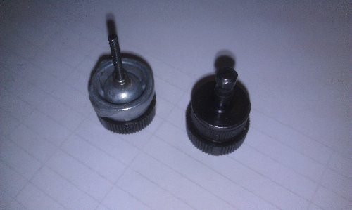

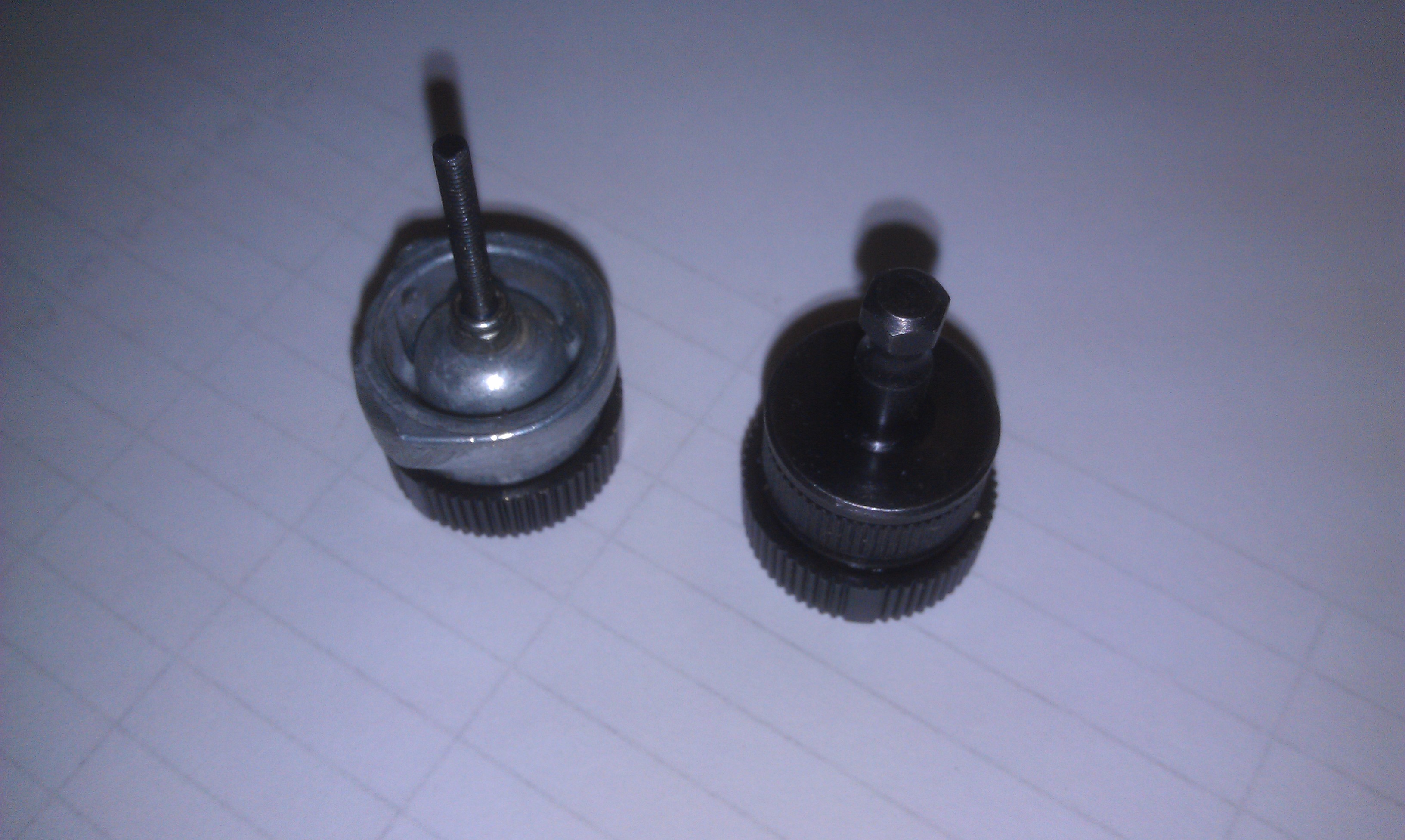

Postby LarryFlew on Mon Aug 25, 2014 3:30 pm
Mine was cutting deep also but it came set at max depth. Few clicks of adjustment and it was right on the mark. My home made vs the new purchase picture.
