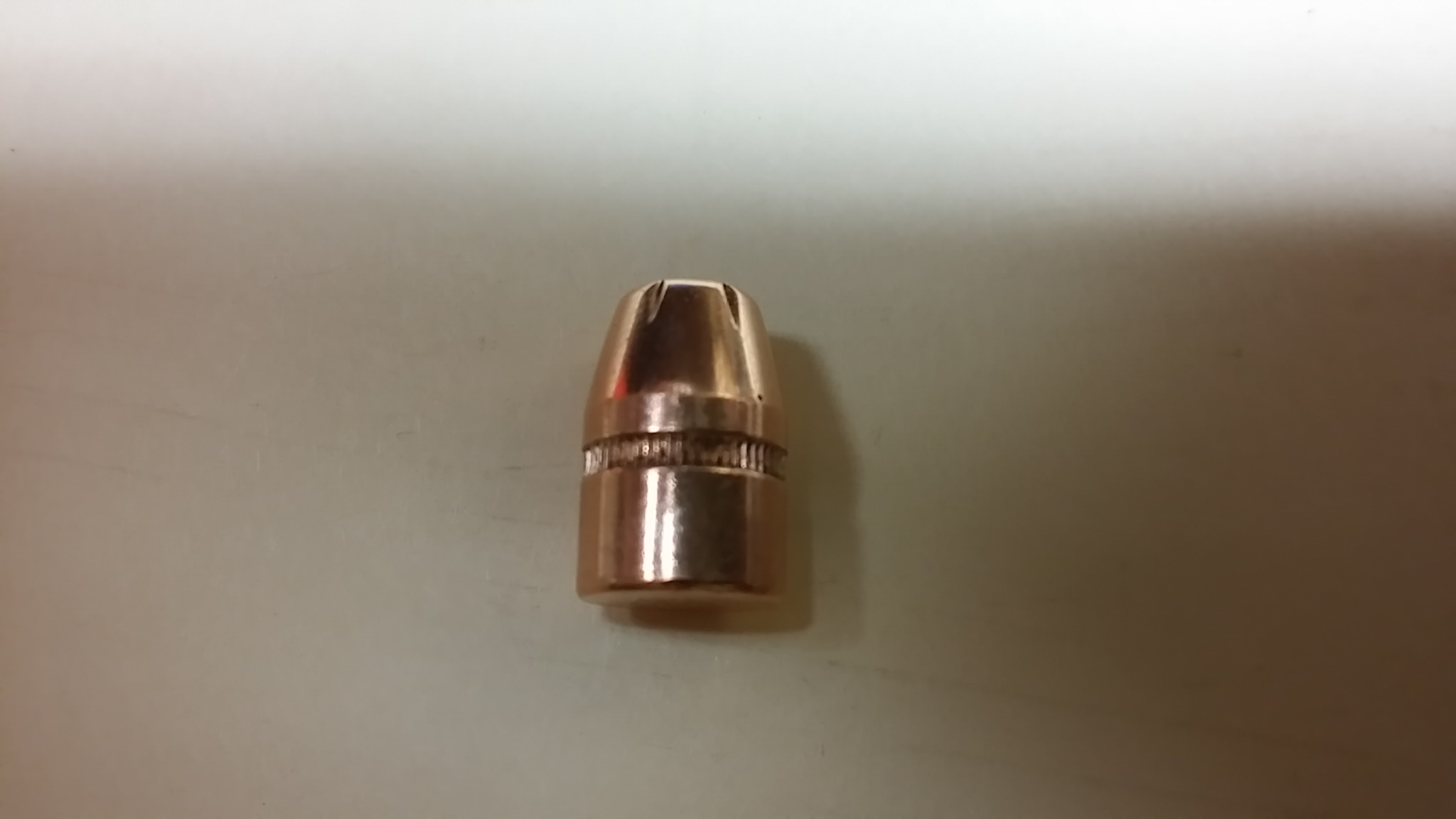

Hornady has 2 XTP 125 grain bullets in .357. #35710 is a hollow point bullet, and is what I have here.
Then they list #35730 and that is a flat point. I don't have one of these to compare with the HP.
Hornady 8th doesn't show different COL's for each bullet, only 1.590" for either.
VV states they used the XTP FP version in their loading data. It may be that the FP version of the bullet is shorter in length, but the base to Cannelure length is the same. If that was the case, then the COL would be shorter if seating to the same point in the cannelure. I'm not seeing in the VV data where they are using SR primers either. They show SP in their data.

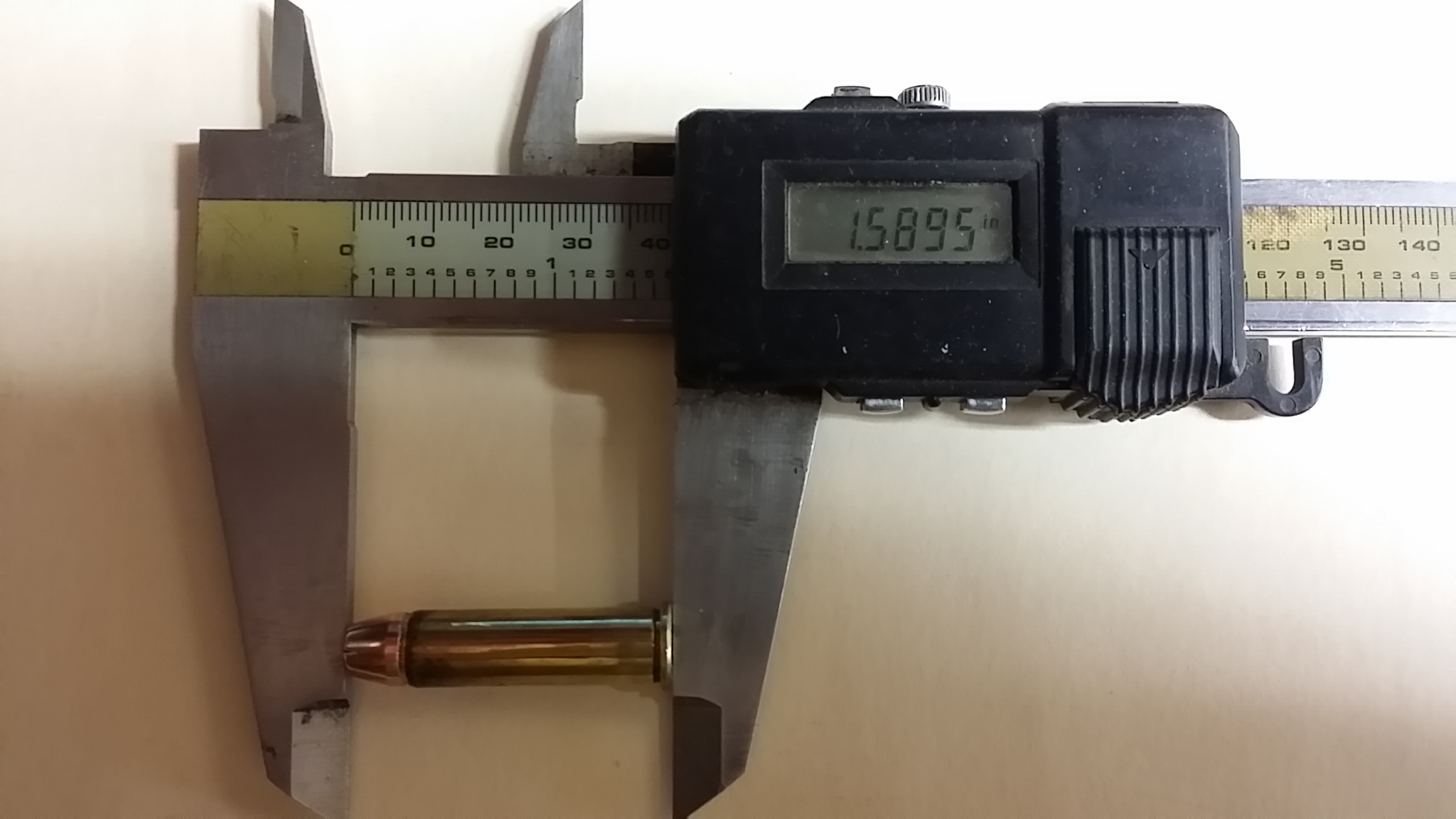

Being as these are a cannelured bullet, seat to the middle of the cannelure, and crimp. With the HP version of these bullets, with my brass trimmed to 1.280, the COL for the cartridge is 1.590" (+/- 0.003") when seating to the middle of the cannelure. This cartridge passes the plunk test on my Coonan.
The HP version measures 0.545" long on average of 10 random bullets checked. With my load, that means the bullet is seated 0.235" into the case, which best I can measure the cannelure to base length, is right in the middle of the cannelure. Does any one have the FP version of these bullets to compare measurements?
So what I'm trying to get at here, is follow what JJ posted about the process of load work-up. Seat to the cannelure to start with, and perform the plunk test to verify your not getting into the lands (I highly doubt they will). With a cannelured bullet, and crimping with a roll instead of a taper, seating to the cannelure is about your only option anyway. Start low, work up the charges and don't worry about compressing the charge.
