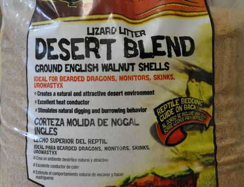

Postby Vlad on Sun Mar 08, 2015 4:26 pm
I have the big Dillon tumbler that I use with Lizard Litter (availble at pet stores, fine ground walnut shells) and the once a year car polish in the orange bottle. You do have to use another capfull or two before every load. The upside is it is small enought that it does not get stuck into primer holes, downside is that it is a bit dusty especaily with the first few loads (cut up fabric softener sheet works well) and does not shine as well as the corncob media.
I also do a lot of pin tumbling. I use a Lortone rock tumbler 12 LB drum I purchased from Mn Lapidary supply http://lapidarysupplies.com which is here in Princeton Minnesota. They also have models from Thumblers. I like the Lortone as it is all rubber and there is only one screw to deal with instead of the 8 to 10 for the bigger thumbler drums and they do not leak like the thumblers do. I made my own tumbler frame and used an electric motor I had laying around. It is uglier that Sam on a bad day so I will not post a pic. It works well and that is all I care about...
No one else has mentioned it so far but to accelerate the drying, I use a dehydrator that I picked up at a garage sale for drying brass after wet tumbling and that is the cat's ass.

Postby Vlad on Tue Mar 10, 2015 7:43 pm
Not quite kitty litter. Lizard litter.
Finer ground walnut than you get from the tumbler companies... does not get stuck in the primer hole so you can easily tumble after removing the primer. Such as to remove the lube after sizing and before you dump powder and seat the bullet. ;)

Postby grimbeaver on Wed Mar 11, 2015 7:11 pm
Vlad wrote:Not quite kitty litter. Lizard litter. Finer ground walnut than you get from the tumbler companies... does not get stuck in the primer hole so you can easily tumble after removing the primer. Such as to remove the lube after sizing and before you dump powder and seat the bullet. ;)
Hum. I might have to go look for that. Thanks for the tip.
