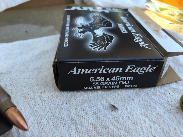

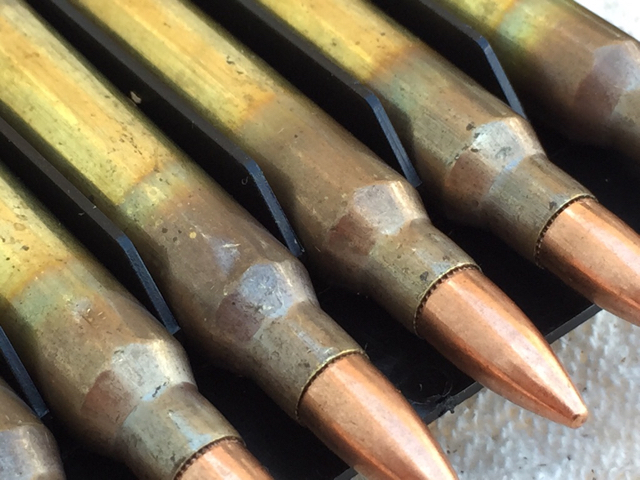

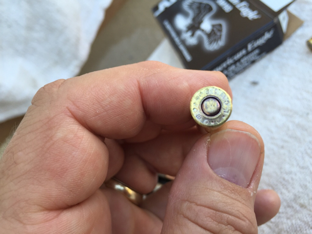

Finally had some time to get some pics of the cartridges, these were picked off a shelf at Cabelas in 20 round packs

Postby Jackpine Savage on Sun Aug 02, 2015 2:32 pm
That is from the Lake City Ammo plant that makes military ammo. It is good to go and a few dents here and there are normal. It has a crimped primer if you are planning to reload.

Postby mmcnx2 on Sun Aug 02, 2015 2:47 pm
I could be wrong (it happens once a year and I'm due) but that brass appears to have been fired given the discoloration around the neck. If I purchased 'new' ammo and saw that it would be back at the store fast. Federals site does not say anything about used brass.

Postby Shawski on Sun Aug 02, 2015 3:14 pm
mmcnx2 wrote:I could be wrong (it happens once a year and I'm due) but that brass appears to have been fired given the discoloration around the neck. If I purchased 'new' ammo and saw that it would be back at the store fast. Federals site does not say anything about used brass.
That brass wasn't polished after annealing, just like .mil contract ammo. It's good to go

Postby fjrdc on Sun Aug 02, 2015 3:31 pm
Thanks for the input this is what I suspected after reading up on it.
