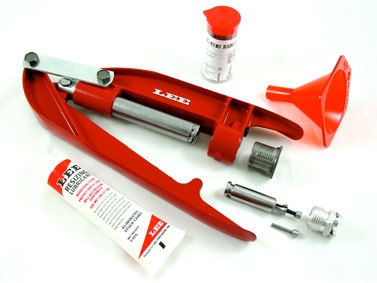

Hello everyone,
I was going to get into reloading and due to space constraints, I settled on getting a Lee Hand Press next pay day and I was wondering if RCBS Dies work in it. I saw some threads online say they do, but the salesman at Cabelas said they won't work so I'm looking for some more input.
Thanks!

I don't own one personally, but I'm pretty sure any standard dies will work fine, including RCBS. Looking at it on the Lee web page, I can't see any reason why they wouldn't work.

If by 'Lee hand press' you mean this (the Wack-a-Mole as Sam says)...
...then I say, don't! I almost did but I went with a Lee turret kit instead and I'm really glad I did. It's the difference between rounds/minute and minutes/round. Here's the authoritative wisdom from this forum back in 2009: viewtopic.php?f=12&t=7381&p=75570
But I think you mean this (right?)...
...which would not be so bad. If you're going to be loading a few dozen at a time it'd be tolerable I think. If space is your limiting factor more than money, a single stage or turret press is still doable -- I've heard of guys clamping their press to one of those folding sawhorse workstands so they can tuck the whole thing away in a closet.
Oh and I see Lee sells this thing:

I'm assuming he means this and I don't know why RCBS dies wouldn't fit. Lee dies and RCBS dies have the same threads.
But personally... I couldn't imagine using that for loading. I got a Lee anniversary kit with the breech lock press and decided it was way to slow after about a week. This one would be even slower than that. Maybe try to find a used single stage press to start with. Might find one for 60 bucks or so with some extra goodies... Ebay, craigslist....?

They fit. I have one and my rcbs dies fit. Lighten up sam.

I own a Lee hand press. It is an older version with 7/8x14 threads vs the newer models which have the breech lock system. While not an ideal press they will work. If I was to load 20-50 rounds it would work fine. More than that I would opt for something better. A single stage bench mounted or a turret type press would be better. Now if I had Sam's money, I would get a Dillon 1050 with a motor drive and never look back. All kidding aside, it is a limited, functional press. I use mine with a universal de-priming die and punch spent primers while watching old western movies. AND to answer your original question about compatible dies, take your pick, anything with the common 7/8 x 14 threads works fine.

Thanks for the replies everyone. And yes it was the hand press that looks like a C clamp kinda. I was kind of looking into the whack a mole one but then I discovered the hand press.
I figured a good starting setup for me would be the hand press, the RCBS .38spl/.357mag/.357Max die kit I saw at cabelas today, and clamp a Lee Perfect Powder Measure to my desk and I should be set to reload! I would get a progressive but I don't think I'm going to be loading hundreds of rounds in a day and finding space for it would be hard since I am moving into an apartment in the fall.
