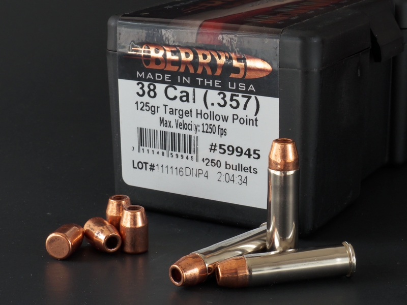

The projectile pulled from the cartridge above weighs in at just around 158 gr., so I don't think it was intended for use in a 9mm round.
BTW, not all .357/.38 projectiles are camel-lured. Plated projectiles from Berry's and Rainier in that caliber don't have them, and they shoot just fine in their intended applications. provided care is taken during the crimping phase to not tear through the plating.

OK good point. I don't use plated bullets, either MO lead or Hornady. Lots of people use plated with good results.
