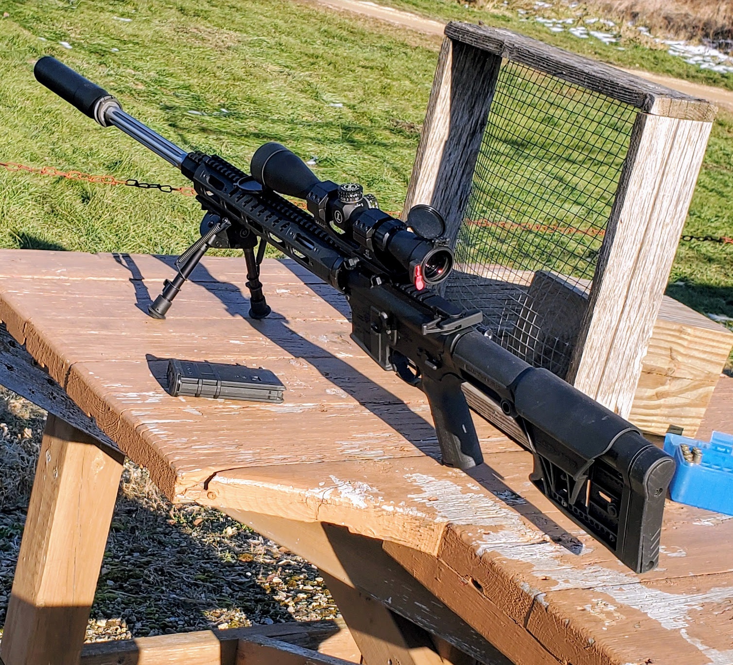

I didn't test for accuracy without the primer pocket work simply because I had the tools (came with the setup a friend sold me) and I kinda hate the load/test/adjust cycle. I just want to pull the trigger.
It's an AR-15 parts gun but the upper is a DPMS 24" stainless steel heavy barrel, a Luth MBA stock, and Geiselle trigger. Nothing super fancy really and I bet it is about 10 pounds overall but I really love it. I recently rezeroed it with the Sig suppressor but didn't really notice an accuracy difference with or without it, just a POI shift of a couple inches.

Here's the rifle I'm currently loading for.
