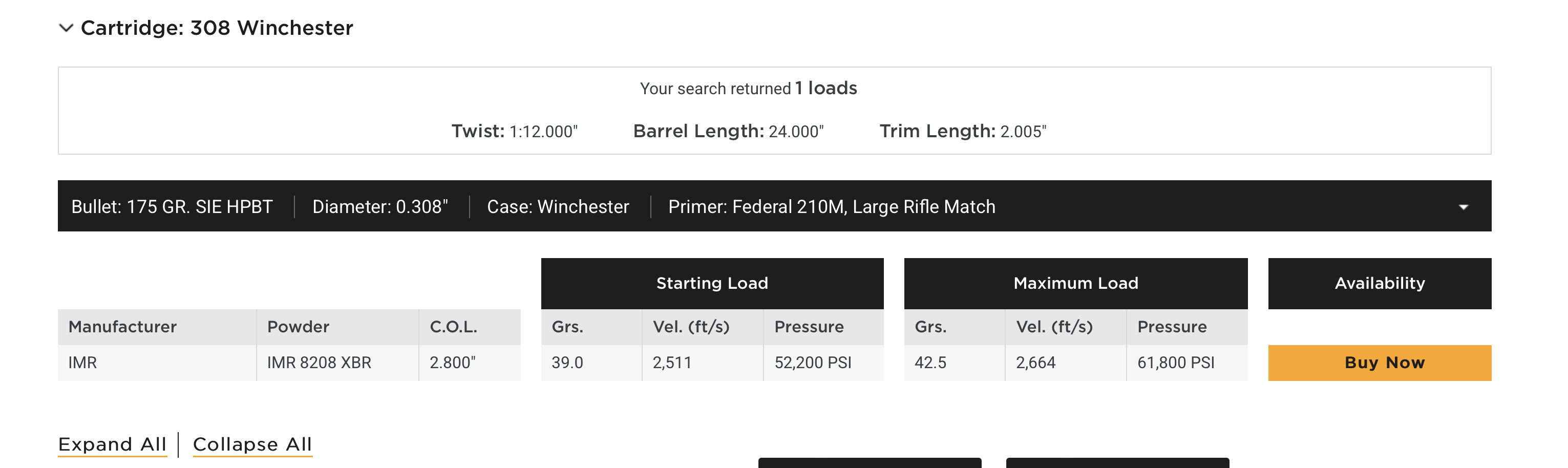

Postby Rip Van Winkle on Mon Oct 13, 2025 5:37 am
From Hornady's website.

Re: Hornady latest reload manual
Postby Bearcatrp on Mon Oct 13, 2025 5:37 pm
Thanks RIP.

Postby ex-LT on Tue Oct 14, 2025 10:22 am
Rip Van Winkle wrote:From Hornady's website.
Two observations...
1. I find it odd that Hornady would list loads for other manufacturer's bullets.
2. The screenshot looks remarkably like the Hodgdon website.
