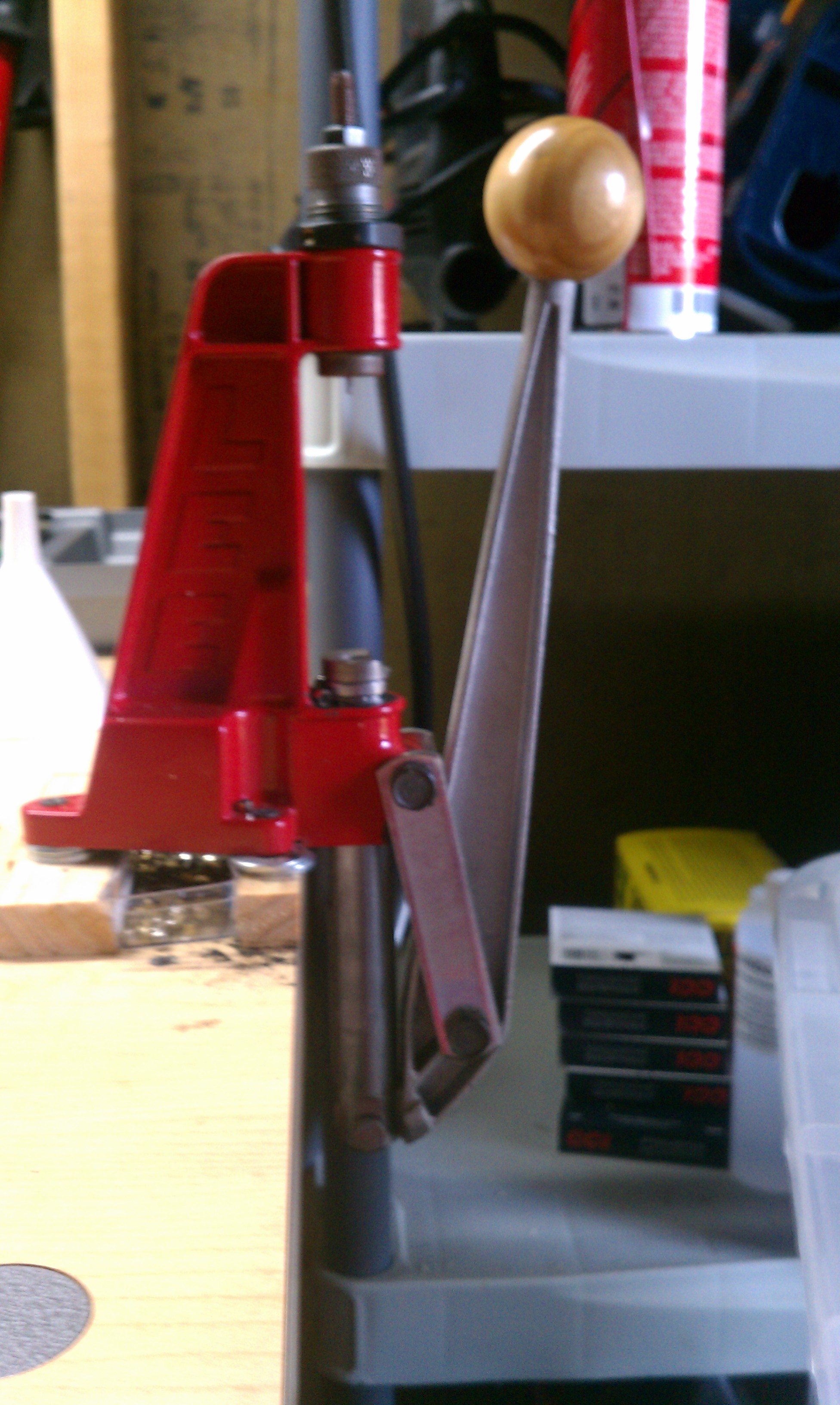

I have this Lee deprimer and sizer and I am trying to use for .45.
I know that when Gecko purchased it, he had only one caliber in mind (9mm) and I know for sure that he used it for 9mm. He complained a lot about it being additional work, blah blah blah, so I have a suspicion he only used it for 9mm. I can't seem to find any extra parts or instructions for it. It looks like I can change out the slot-thingy that the 9mm casing would slide into, so I assume the press itself is not caliber specific.
My questions are:
1. When you buy one of these presses, are they for one caliber only? Or do you buy the press and order the attachments for the caliber you want separately?
2. Where can I buy something like this? Or get attachments? Or instructions?

If the die (top screw in pc) is 9mm specific you would need to purchase a universal decapper or the die for your caliber as well as the shell holder on the bottom. If the die is universal it will be wide and smooth on the inside. Try it with a 9 mm case and decap one. If it pulls fairly hard coming back out it probably is a resizing die. If it comes up easily it is likely universal. Then try a larger caliber like 45. If it doesn't fit into the decapping die it isn't universal.

LarryFlew wrote:If the die (top screw in pc) is 9mm specific you would need to purchase a universal decapper or the die for your caliber as well as the shell holder on the bottom. If the die is universal it will be wide and smooth on the inside. Try it with a 9 mm case and decap one. If it pulls fairly hard coming back out it probably is a resizing die. If it comes up easily it is likely universal. Then try a larger caliber like 45. If it doesn't fit into the decapping die it isn't universal.
I tried it out and the die is definitely 9mm only and for resizing. Do you know where I can buy a decapping die and a shell holder?

That is one of the basic Lee C-style presses, you would want to pair it with the appropriate die set for the caliber you are trying to reload (9mm Luger, .45 ACP, etc..) - Lee makes good, affordable 4-piece carbide sets for around $40 per caliber that include a decap/sizing die, expander/charging die, bullet seating die and a factory crimp die plus a powder scoop, shell holder and some basic reloading data (Cabelas in Rogers and Gunstop in Minnetonka both carry them locally). They can also be ordered online from Natchez Shooting Supplies or Midway USA among many others.
If you don't have one lying around I'd suggest picking up a Lyman's 49th edition reloading manual to review which will include both instructions for operating your reloading set plus some good loading data. Good luck!

Pretty sure Lee die sets come with a shellholder, otherwise you have your usual sources.
Midway, cabelas, Gunstop, Bullseye shooters supply.

Yeah!! SLOT THINGY???? Someone needs to RTFM before they go any further with their reloading attempts!! Shellholder heads are pretty much interchangable regardless of brand for an single station or turret press, and so are the dies. Never heard of a press for a single caliber set of dies, because 99.9% of all dies are 7/8-14 screw threads. The one exception are 50 BMG dies.
