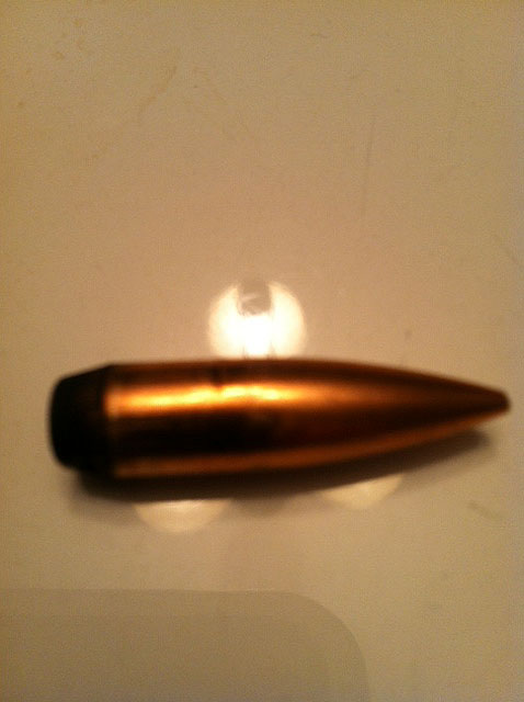

So what do you all think happened to cause this bullet to become stuck in the breach or barrel of 700 308? Was at noisy outdoor range with another member, visiting, I believe I pulled the trigger and click nothing ,thinking I didn’t cycle earlier shot, pulled the bolt ejecting a what I thought to be a spent casing. Only when trying to load another shell that wouldn’t lock up did I realize something was not right. Isn’t it unusual for a riffle round to do this? Thoughts…

improper seating? or missed powder charge.
Reloaded just long enough that the landing grabbed the bullet and/or, the primer was enough to set the bullet into the rifling. Can't really tell from the pictures how far it was into the landings.
did ANY powder come out when you ejected the case?

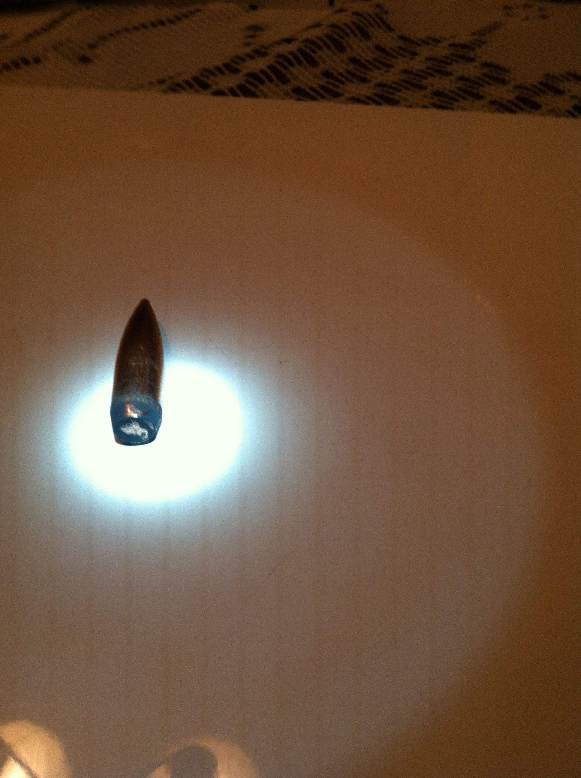

The saved bullet had some residue, (click photo is large file)burnt sticky looking black charred hanging on the very end, not sure it shows up in the photo that well. Was not much at all. Unfortunately, because of outdoor range dirt and contaminates, the brass went immediately into the tumbler. That day I was shooting the riffle tripod fixed on a black mat that covered the range table completely and there were no unspent powder grains to be seen, I looked. Here is a better photo of the bullet showing residue, hope this helps. Oh I should add what I’ve gained thus far; don’t share loads with anyone. I think also it might be helpful if I didn’t bring so many firearms with, consecrating more on a couple, this might well have made for more evidence being documented rather than a quick note. That day I had four riffles, and six handguns in eight different calibers, and several loads with. I’ll be able to leave the pack mule at home, wait I’m the pack mule. I’ll be looking forward to learning riffle, processing the 308 round.

The crud on the back of the bullet DOES indicate unburned powder, as just the primer has hardly any residue and I doubt all of it together would amount to as much as is on the base of the bullet. Other causes could be a firing pin with crud on it or obstrcting the hole, and I HAVE had erratic ignition on my Smith 500 due to this. Have also had erratic ignition from a charge that was too light on my Smith 500, and in that case I did wind up with a wad of powder sort of clumped together in the case. In a .308 case a clump of powder couldn't come out of the case, so it probably stayed in there. Tumbling all the brass right after you got home was a HUGE, MAJOR mistake. After a near-KABOOM experience you leave EVERYTHING the way it is so you can check it out later. What happened to the unfired loads after this happened?? Have all the bullets been pulled and the charges weighed?? PLEASE don't tell me you had a near death experience and then finished off the remaining box of loads!! :( :o :shock: :?
While the guy's method does sound pretty close to foolproof, I still think checking all 50 cases AFTER filling lets you know all the stuff is equal in the block, and that equivalency check is missing from his procedure. Unfortunately, I think the chances of a faulty "light" primer are practically nil, and I've never heard of this being a documented problem. Plus if you know the way they make these things, it's pretty hard to not fill up the hole with priming goop on the assembly plate, so I'm not buying a light primer load as the most probable option. I doubt it's even close to being most probable. I would go with partially obstructed firing pin 1st, and incorrect powder weight 2nd, and maybe some leftover concob plugging up the primer hole as #3. Does the guy deprime and polish his brass, or the other way around?
