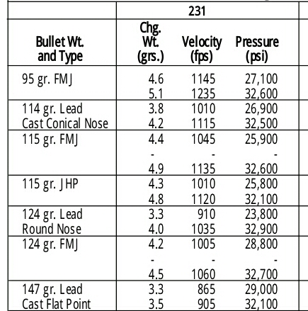

Thanks to all, didn't know about LoadData.com, can check that out as well. Yes, the hollow base does have me wondering what the OAL should be when it isn't supplied and for this particular bullet. OAL as I understand what I'm reading is a significant part of the puzzle. Rugersol, the info you provided is a good example, as a newcomer to this, how would I know?
Gotta believe there should be some data somewhere for Winchester brass, 231 and this particular bullet. Seems odd to me, not like they just started making it, I guess I'm surprised to have not found anything on this configuration. Not like I'm looking for 'here use this and you'll be fine', but to find some baseline seems to be way harder than I thought it would be.
So per the chart provided by rugersol, I can start at 4.4 and max out at 4.9, just need a OAL. So do you guys load and test of 10 rounds first before loading another 10 at the next level?

Postby rugersol on Sun Jun 30, 2013 9:00 am
MarkL wrote:Rugersol, the info you provided is a good example, as a newcomer to this, how would I know?
Lotsa interlinks searching ... hangin onto old .pdf's when ya find em
... as a general rule, when a new version of data is published, the old data should not be used ... as the formula, and how the powder burns, may change, over time
however, when yer choice is "somethin" vs "nothin", I'll generally take "somethin" into consideration!
ya want at least two sources of data ... preferably three ... if one is simply an older version of nother, that somewhat defeats the purpose ... unless it's different ... then, IMO, it's worth some consideration
when all else fails, ask for help (like ya did), guess, er sell yer components and replace em with ones yer otherwise comfortable with ... I don't recommend ya guess ... but to answer yer question, that is what some folks are doin ... at the very least, it shouldn't be yer first option, and after nuff research, hopefully if ya do guess, it's a damn good one!
IMO, the min is only relevant to the risk of a squib, or "flashover" ... with the cast data havin a lower min, I'd say it's safe to presume the min fer the jacketed is against a squib ... so, 4.4 s/b fine ... bring a squib rod ... check the bore ... check fer pressure signs ... use a chrono, if ya can ... work up to 4.7ish
this is a purdy small window ... so make sure ya got good readings on yer scale ... do 10 drops, and divide the total by 10 ... w/o at least a 0.005g (gram) scale, there's no way to know how consistent yer measure is ... but if 231 meters well, with the 10x method of setting it, ya s/b ok ... jest keep a close eye on it!
most any reasonable oal s/b fine ... but if ya ever shorten it, start over from 4.4 er less, and work back up, again ... same with a new brand/style of bullet!
