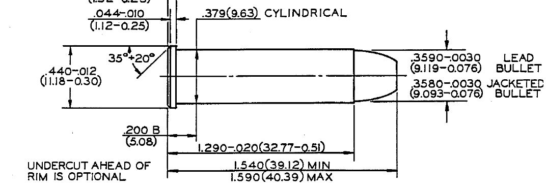

usnret wrote:First off what caliber is this? I am thinking maybe 38 special.
Secondly if it is, you are making this much harder than it has to be. If it is in fact 38 special, then just buy 38 caliber bullets. Then your only dilemma will be, what weight bullet to get.
highwarden wrote:Slugging the bore is first and foremost for safety when reloading for older guns, modified guns, smith and home made guns, guns manufactured outside the U S, guns manufactured for foreign governments, etc. In other words any gun where you are not sure of the bore.
For example, several people have been injured and killed by using .243 bullets to reload for a 6mm Lee Navy. Another example, 7.62 Russian is not the same bore as 7.62 NATO. I am sure there are other examples out there such as the various chamberings labeled as .44 or .45.
Remember when reloading RTFM means Read The Full Manual then measure.

Jack's My dog wrote:And just to be clear.. reading my manuals has led me to ask these questions.
Jack's My dog wrote:I think I may have convoluted my main concern, by asking to many questions in the same post, but in regards to the diagram itself...not so much .357 specifically.....I am reading the diagram correctly right?
