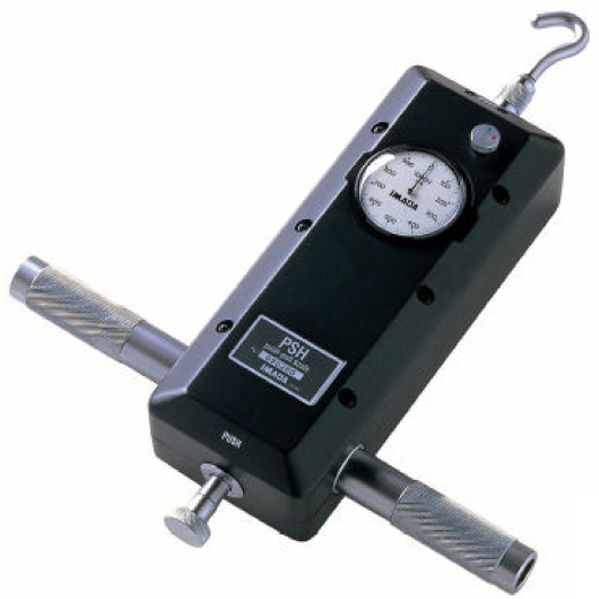

Uh, yeah, you can:
http://www.ebay.com/itm/like/280800569039?lpid=82
And since it is a bottleneck cartridge, I'm sure the Redding will make you a competition bushing die, that you can tweak your neck tension .001 at a time. And then, you can take one of these: http://www.midwayusa.com/product/680804 ... let-puller and attach a shellholder to this: http://img.directindustry.com/images_di ... 459657.jpg and magically, you can quantify your annealing, neck tension, crimp tension, and put actual numbers to all of the above!
