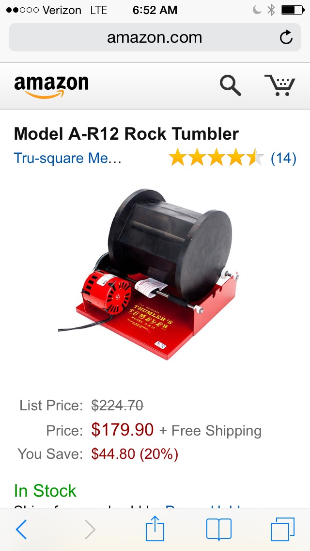

Postby Deputyhiro on Sat Jun 07, 2014 5:54 am
Got the thumblers ar12. I load the hell out of it. Works great.
