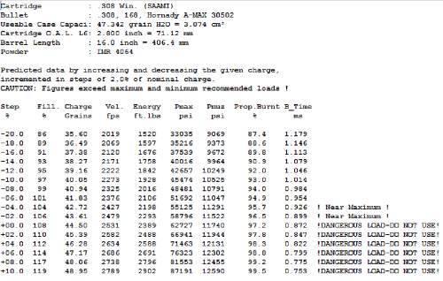

I guess the question about taking a class was more about reloading practices than AR function. If you've been soft-loading your AR's with no malfunctions, then more power to you. The things that are important for loading .50 are the same with smaller calibers. Using your provided data and generic case capacity numbers, the load of 44.5 grains of IMR4064 generates 62,727 psi, and has 108% case fill. It's what QuickLoad refers to as a ***DANGEROUS LOAD - DO NOT USE*** Blown primers would not be a surprise with those numbers.

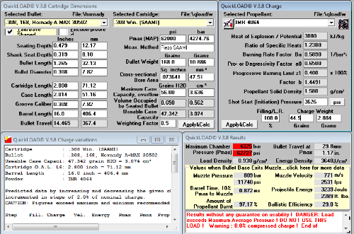

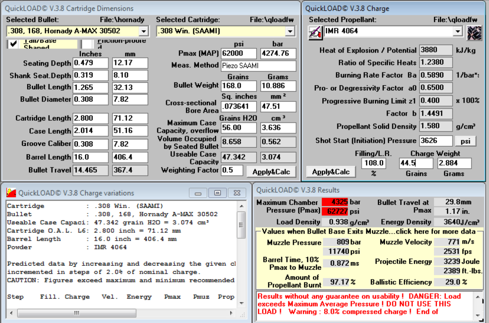

You're not listening or reading properly. He said his data was from QuickLoad, which I also swear by. You're cooking up some very hot stuff with multiple powders at once, and that in itself is a mistake. Just because the book says it's safe doesn't mean DIDDLY SQUAT with your rifle, scale, brand of brass, and chamber dimensions. If Quickload says the pressure is in the 60's, then that's what it is. Could somebody please post the upper right panel of the Quickload screen to show him all the stuff that goes into calculating this. Better yet, just post the whole screen that shows this load to be in the 60's.
Re: Varget ?

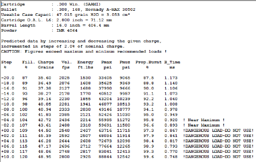

Postby Erud on Mon Apr 20, 2015 6:05 pm
Here you go:

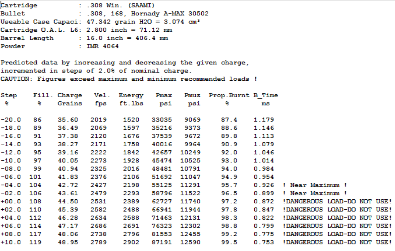

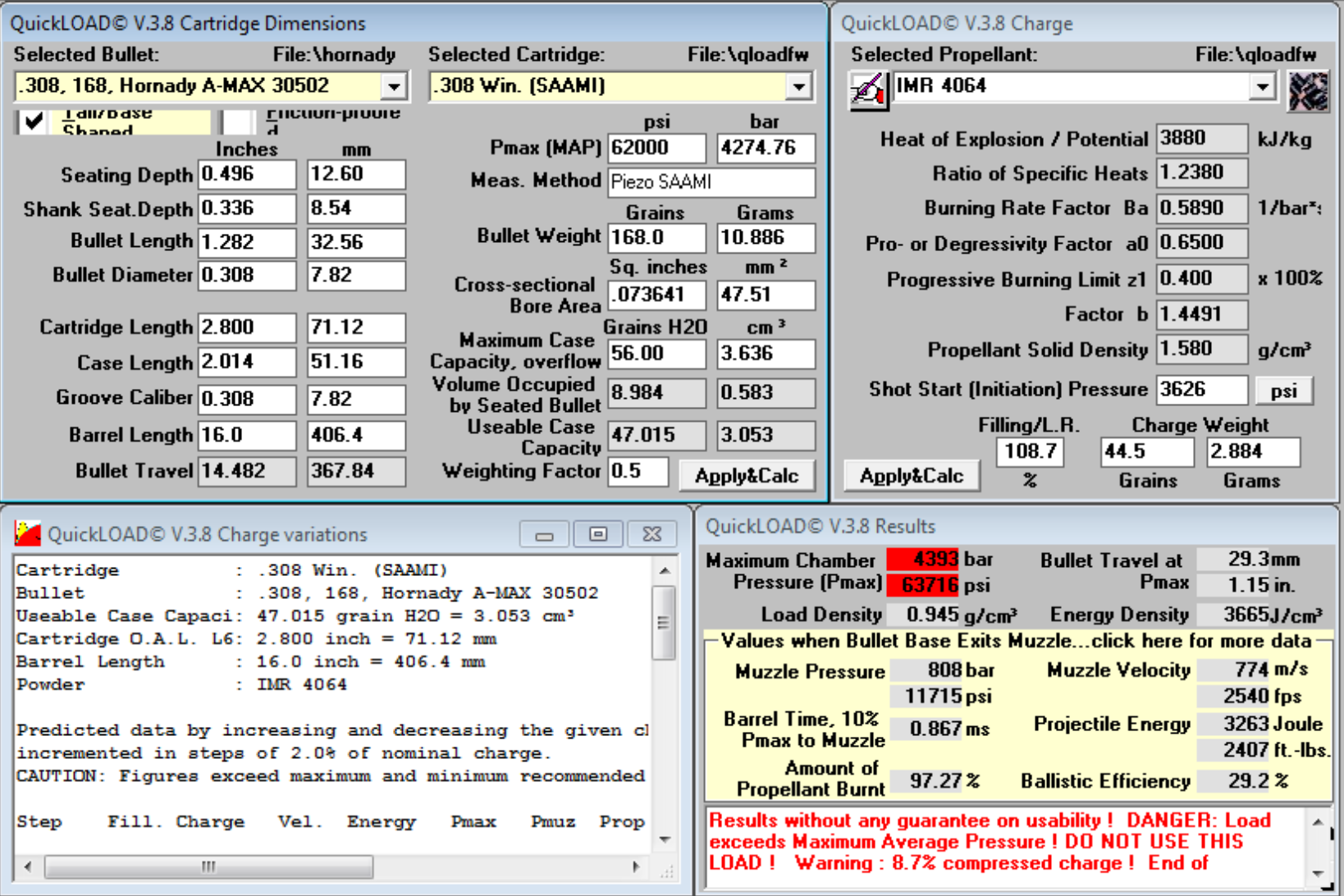

Postby Erud on Mon Apr 20, 2015 6:08 pm
And actually, I just noticed that QL shows the 168 AMAX to be a little shorter than Bryan Litz measured it in his book. If I change it from 1.265" to 1.282", the pressure gets even higher:
