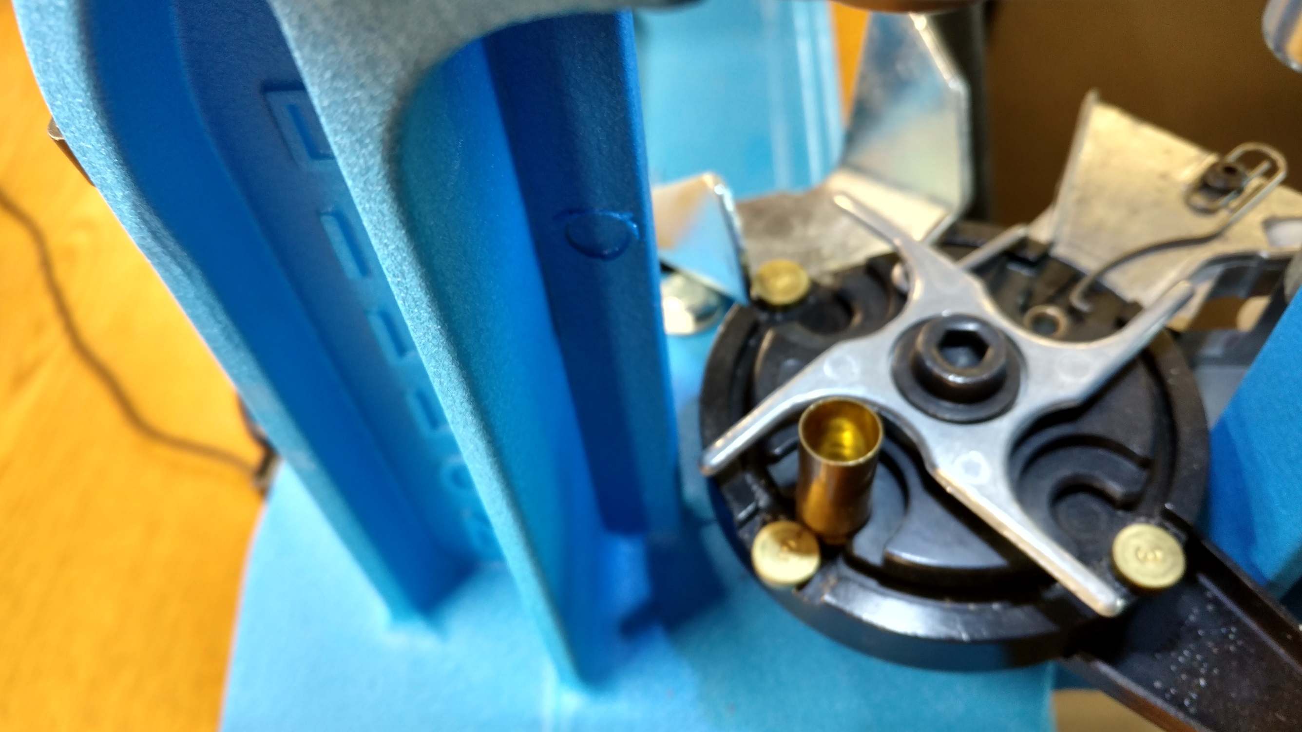

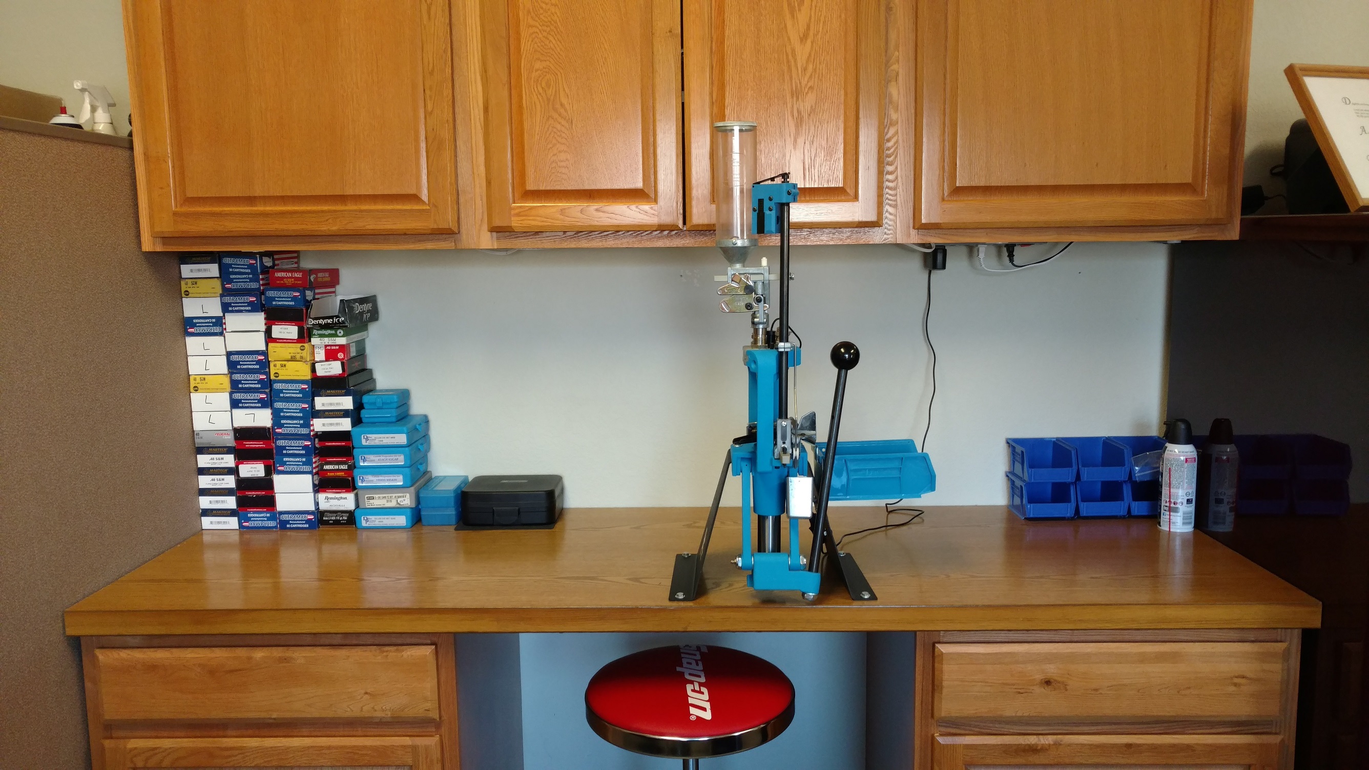

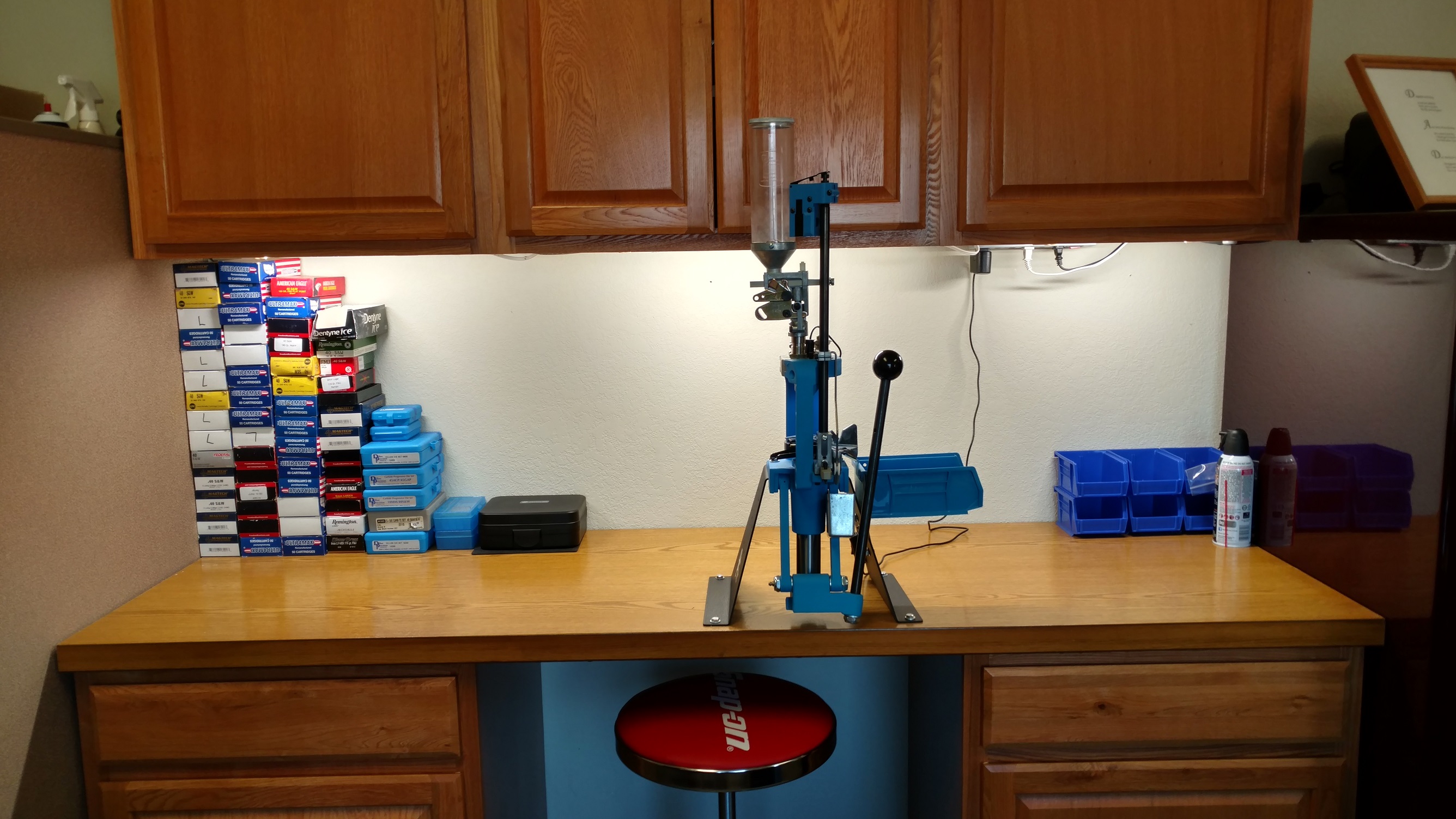

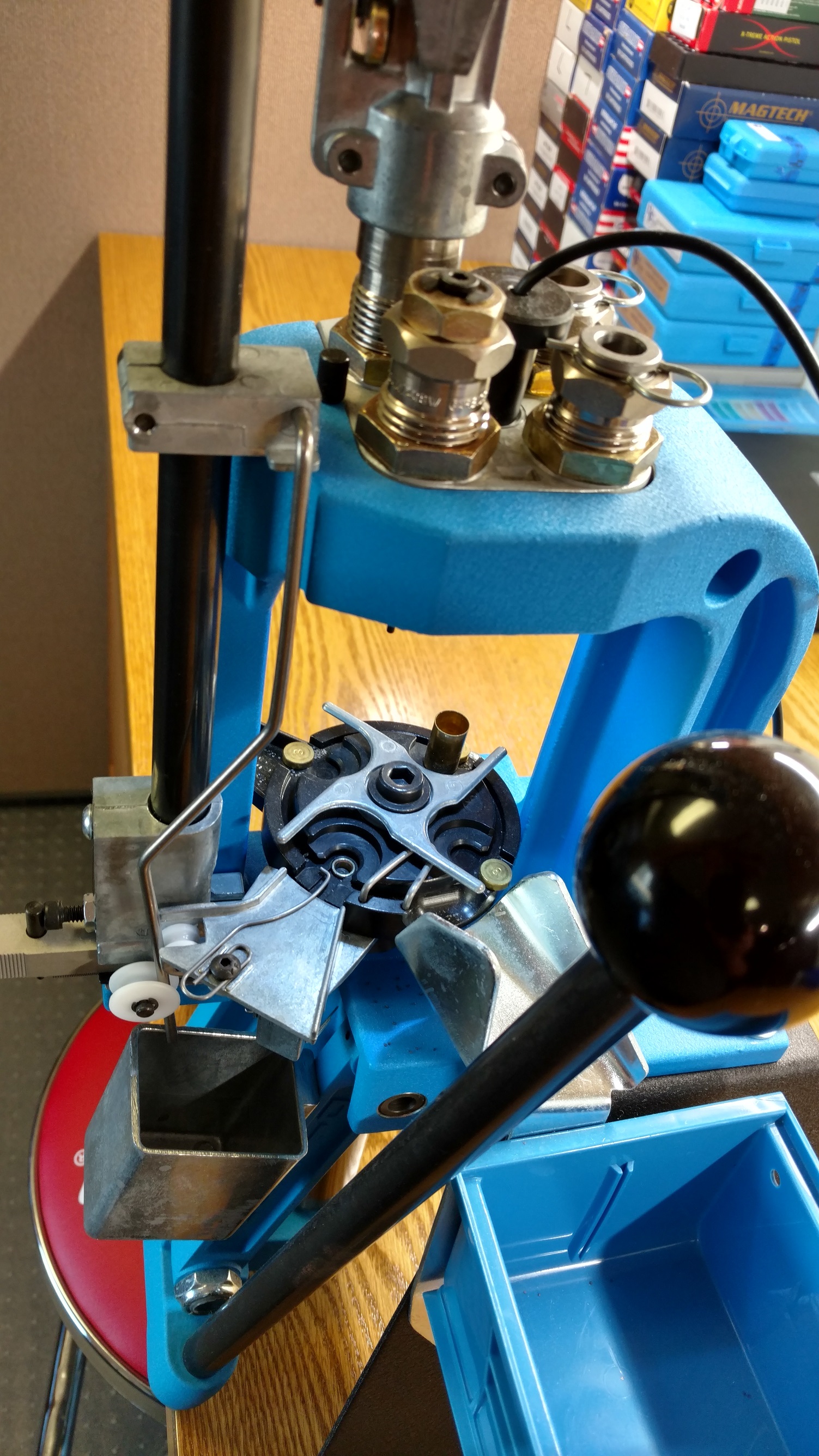

Postby brad3579 on Tue Mar 08, 2016 4:37 pm
I am using LED's under the upper cabinets and an LED on the re loader. The picture with the under cabinet lights turned on does not really show how bright the room is as for some reason the camera dimmed the picture.

Postby SkyRock on Tue Mar 08, 2016 5:06 pm
Could you give more info on the "LEDs on the reloader?"
