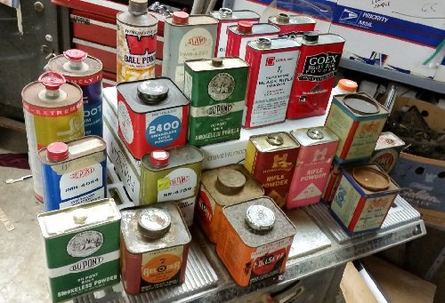

Thanks guys. Got a LOT of different powders including (2) 1 gallon freezer bags of fertilizer for sure. 3 bottles (different kinds) smell great and look great. The TG looks good but has almost no smell so I wanted some other opinions before giving it a shot. The newer bottles are not shown in the picture.

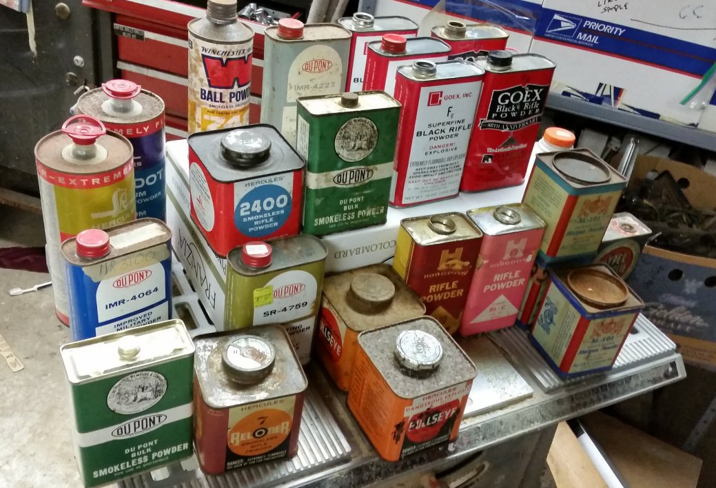

Postby crbutler on Tue Oct 24, 2017 10:46 am
Well, the black powder shouldn’t be a problem.
Some of those types of containers I still have and use. Running low on the Alcan though...
Depending on how it has been stored some of those can still be good, and some of those containers are collectibles now in their own right.
crbutler
Posts: 1758 [View]
Re: titegroup question
Postby LarryFlew on Tue Oct 24, 2017 5:25 pm
All of those pictured are empty either because they already where or where bad by way of smell or looks.
