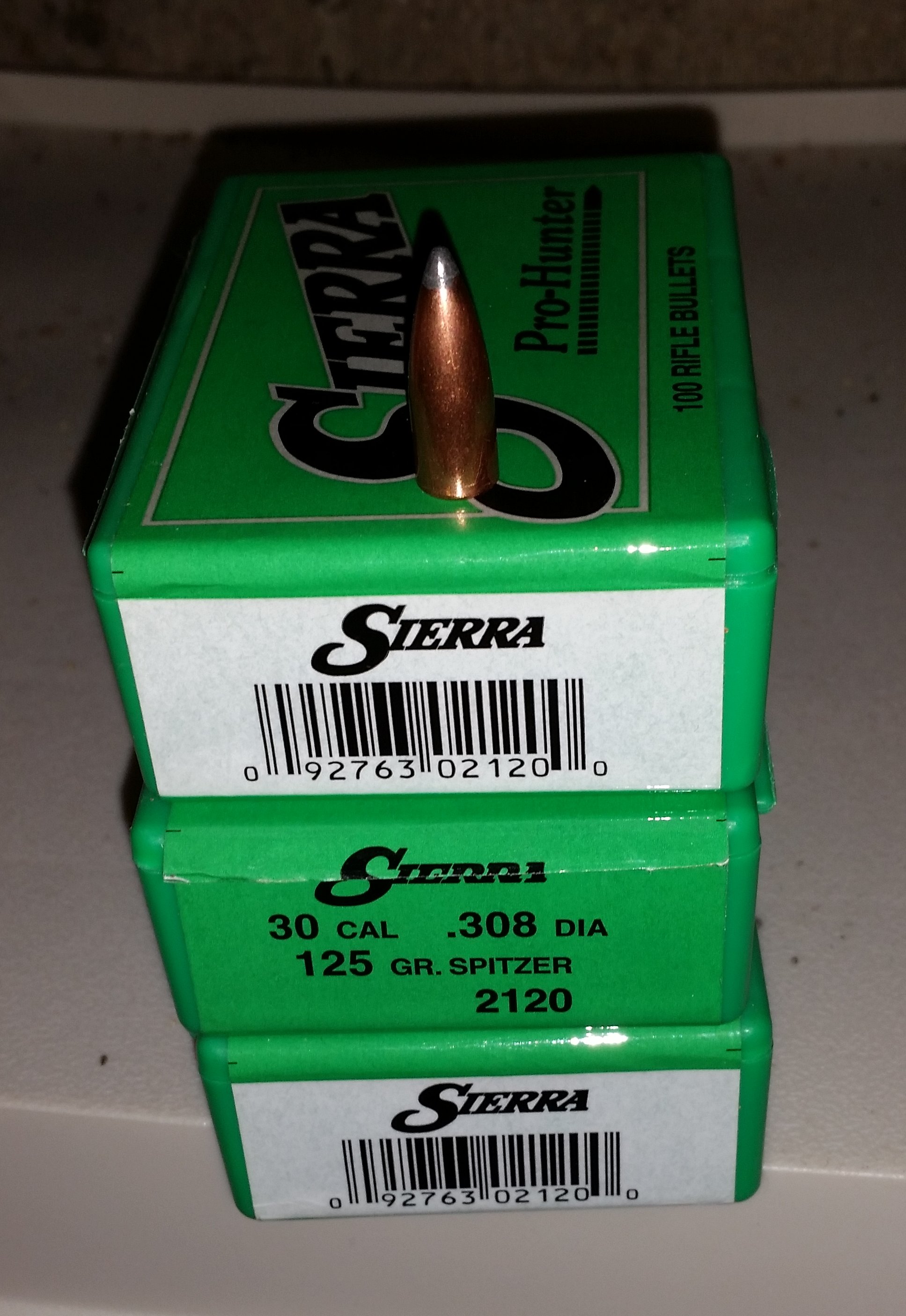

Postby LarryFlew on Sat Dec 09, 2017 9:33 am
Sierra 125 spitzer and H110.
