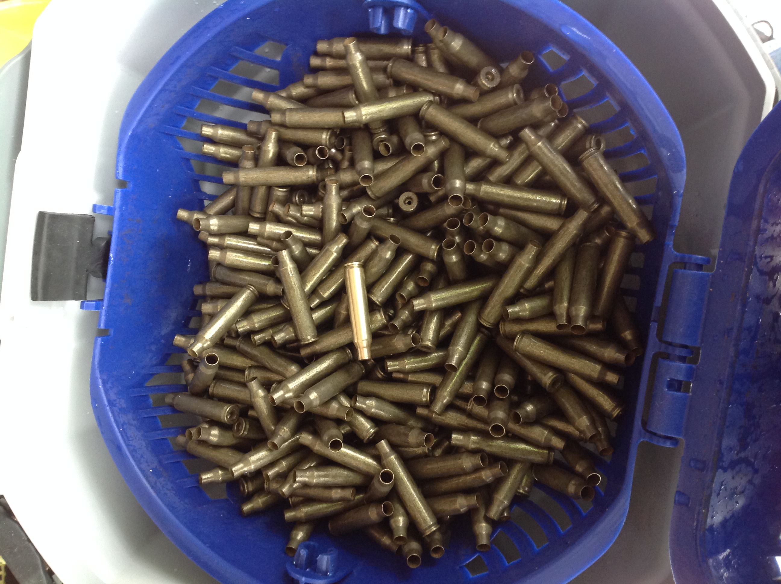

I STILL am having issues! I've cleaned the pins, the tumbler has been used for around 6-7 'loads'. I punched primers last night and threw in a couple hundred cases, followed by 1 cup full of pins, 1x tablespoon of Lemishine, 1x tablespoon of Dawn dish soap and filled with water to about 1.5-2" of top. Tumbled for a couple hours. Drained....blackened brass. Repeated again. Still dark sticky brass. Third time around- see pic. Rinsed and still NO difference! I took a towel to one and put it in the middle of the separated ones. Ugh!

Postby BigDog58 on Sun May 30, 2021 3:54 pm
Use more Dawn and pins. Let them tumble for at least 2 hrs. and see if that helps. Don't forget the Lemishine.
Re: Dull sticky brass after wet tumbling (?)
Postby xd ED on Sun May 30, 2021 5:48 pm
Yep; use more soap. As long as you fill it with water so it cannot foam, you cannot, within reason, use too much detergent...maybe some more lemon shine.
Does your house use a water softener? If so are you using softened water?
Are you using hot water? (recomended)
When you cleaned the pins, was the water eventually clean?
You mentioned using a cup of pins; do you have more pins? If so, use all of them, assuming you put them through a cleaning process-tumbling them in hot water with plenty of detergent...maybe 2-3 times...
