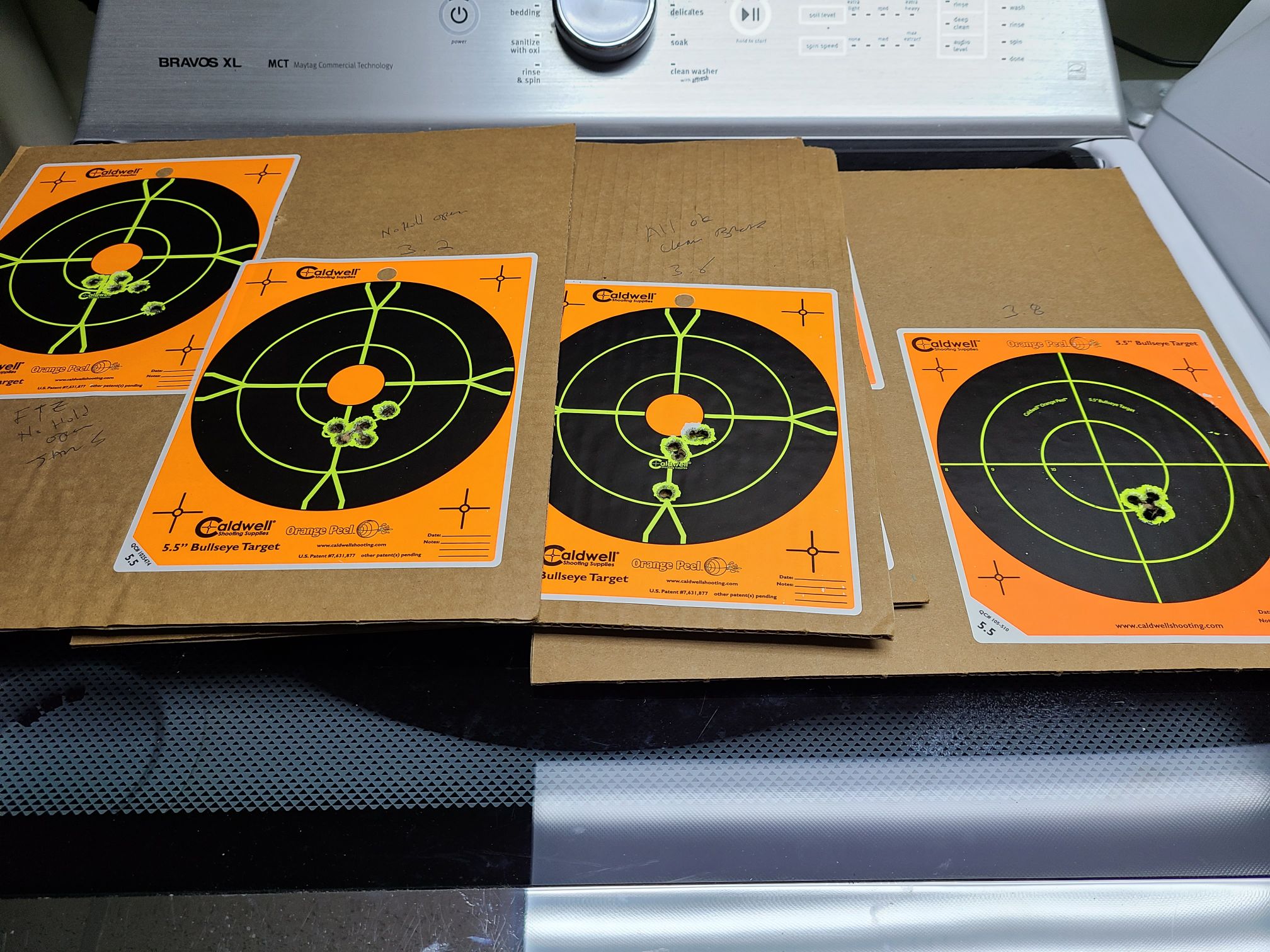

Postby samginko on Sun Feb 14, 2021 12:54 pm
Thanks for the input. Only loaded 45acp and . 357 (cowboy). I think I will work up the W231 from 3.2 to 3.7.
samginko
Posts: 690 [View]
Location: Eagan
Re: 9mm subsonic powder coated 147 grain bullets
Postby samginko on Fri Feb 19, 2021 9:27 pm
Seems consistent at 3.2, 3.6, and 3.8. ftf at 3.2 and little pressure signs at 3.8. so 3.6 seems a good choice.
samginko
Posts: 690 [View]
Location: Eagan
Postby crbutler on Fri Feb 19, 2021 11:21 pm
Good for you!
My usual IDPA 9mm load is a 147 ACME coated TCFP cast bullet with 3.0 gr of titegroup. 2.8 functions, but doesn't make power factor for that game in my gun. However, it does not function my PCC. Unfortunately, finding powder is a bit of a chore right now, so what you have is working, and looks pretty accurate.
It is pleasant being able to get more than 2000 rounds for a pound of powder.
crbutler
