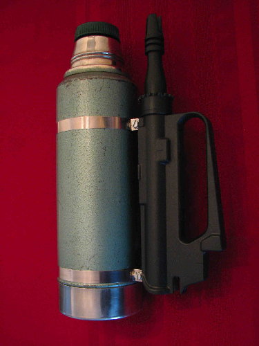

As promised.
I finally completed the AR handle for my gun show thermos. I could not locate a shot-out barrel so decided to make my own using the dimensions of a good one I acquired from a friend. To keep the center of gravity low, I turned a piece of 4” phenolic, rather than steel, to the same contour of an actual barrel and cut some 1/2 x 28 threads for an A-1 flash suppressor. A little black textured paint and it matched the receiver. Maybe I should make it really "bad" and paint the thermos black also. Yah I know, too much spare time but it is unique and will make a good conversation piece.

Postby JFettig on Thu Dec 24, 2009 7:07 am
Cool.
Is that a forging or a completely finished upper?

Postby Leech on Thu Dec 24, 2009 4:30 pm
JFettig wrote:Cool.
You need one of these to go with it:
Hot damn, I love the mug and need to get one to go with the thermos. Thanks for the great tip.
Holly crap, I thought it was plastic. $279 and no carrying handle? Now I have another project to work on.
The upper is partially finished and was a booboo because of some milling errors or was used to set up a CNC mill. A gun show vendor had several on his table for $5 each and I just could not pass one up. At the time, I did not know how it would be used and now I wish I had purchased all of them.

Postby mattxd on Fri Dec 25, 2009 11:50 am
I got bored a while back and whipped it up in Solidworks it's doable but 279 is a bargain if you have to pay for machining.

Postby JJ on Sat Dec 26, 2009 8:41 am
Gotta imagine machining on that bad boy would be crazy expensive. But a straight walled stainless mug probably could be easily disassembled (usually they have a plastic liner glued in). Holes could be drilled through the jacket, cheap picatinny rail blank can be purchased in various lenghts http://www.brownells.com/.aspx/pid=2670 ... RAIL_BLANK ,and drilled and tapped to match the mug jacket. Glue the liner back to the "improved" jacket, a little Duracoat, black buzz bomb, ect.. Just a thought

Postby FJ540 on Sat Dec 26, 2009 1:57 pm
Edit: Just saw the website for the battle mug.
I would think they'd be better off casting them rather than turning out so much scrap in machining them. Not to mention the machine time and wear they're causing starting from rather expensive raw stock.

Postby FJ540 on Sat Dec 26, 2009 2:01 pm
JJH wrote:Gotta imagine machining on that bad boy would be crazy expensive. But a straight walled stainless mug probably could be easily disassembled (usually they have a plastic liner glued in). Holes could be drilled through the jacket, cheap picatinny rail blank can be purchased in various lenghts http://www.brownells.com/.aspx/pid=2670 ... RAIL_BLANK ,and drilled and tapped to match the mug jacket. Glue the liner back to the "improved" jacket, a little Duracoat, black buzz bomb, ect.. Just a thought
With the rails you linked, you'd still end up at $200 before having a mug. I didn't look in my catalog to see what the dealer price is, but it's still probably up there.
You'd do better to go to the ready-made stuff that has the holes drilled and costs about $10 a pop - it'd save ya 75%.
