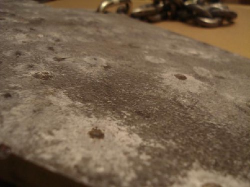

guess I would want to see pictures of the plate that was actually shot. I just struggle to believe that it would have just shrugged off a .223 round.

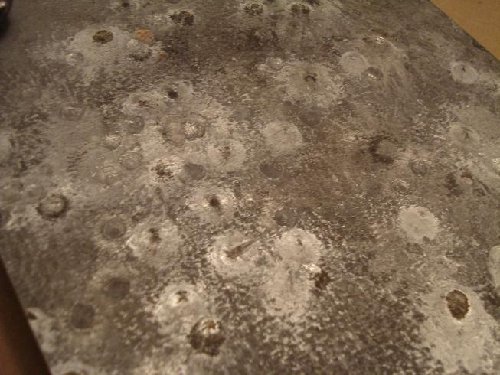

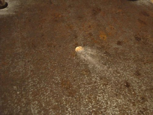

Postby Sigfan220 on Sun Feb 07, 2010 10:18 pm
I have pics from the testing. Keep in mind in addition to the 223 we used HOT 22-250 and 243 loads for South Dakota prairie dogs. My 243 was loaded with 75gr HP's loaded for SD dogs and cyotes. These loads will scuff the plate a bit. We sent about 200rds down range with the rifles. I would say if you want to shoot 243's and 22-250's back the target up another 50-100 yards. Bullet spray is a concern with steel - the snow was gray for 4-5 feet and jacket fragments were found much further.
The first picture is a single 223 round, the target only shows lead and copper deposits. The other two include the 22-250 and 243 shots. They rough up the surface a bit but the integrity of the target remains.
