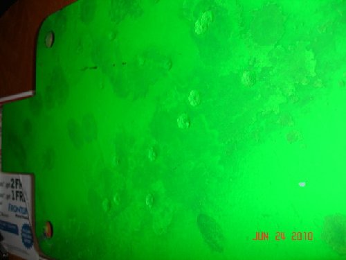

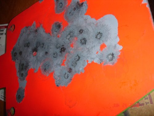

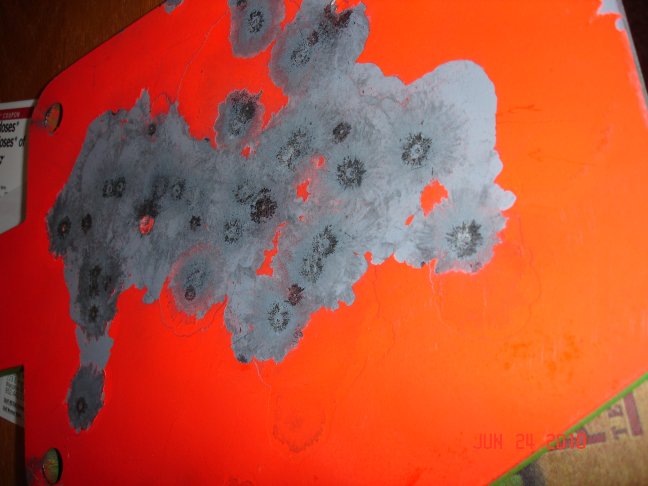

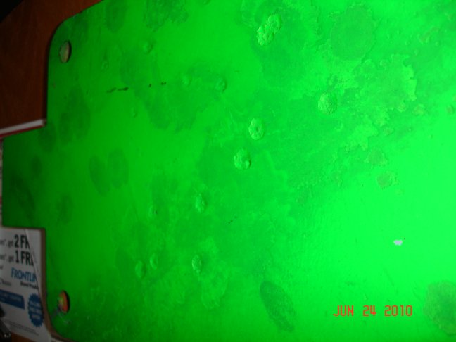

Update. Now have about 600 rounds into each side with the pictured results.
The green side has had nearly that many BUT look close and you will see about 20 pock marks - one magazine of incendiary 5.56 that kind of melts into the steel.
The orange side has had over 600 rounds from 22 to 45 in pistol and rifle 22, 17HMR, lots of 5.56 and one 270 YUP look close that one left a mark about at the heart.

LarryFlew wrote:Update. Now have about 600 rounds into each side with the pictured results.
Holly cow!! You really tested these things out :o I can't believe how little damage the incendiary bullets did. Just ruffed up the surface a bit from the looks of it. Thanks for the range update.

Incendiary pockS are worse than they look and where from about 150 yards. Most where long yardage shots but very little damage.
Don't need a freeby if this keeps holding up. Have to see how it does for more close 45 etc.
