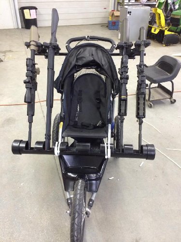

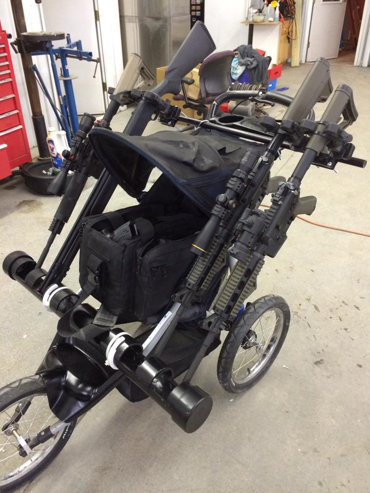

Postby CarRacer on Tue Mar 11, 2014 7:33 pm
Cool cart, it's not my idea though. I just followed what I saw on Brianenos.com, just like you did.
I finished up my cart this weekend. I ended up making my own long gun mounts using plumbing standoffs and 1/4" square tubing.
