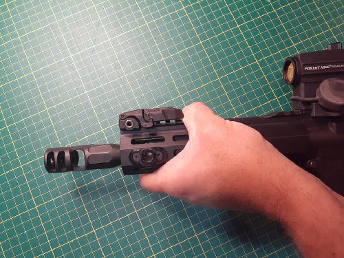

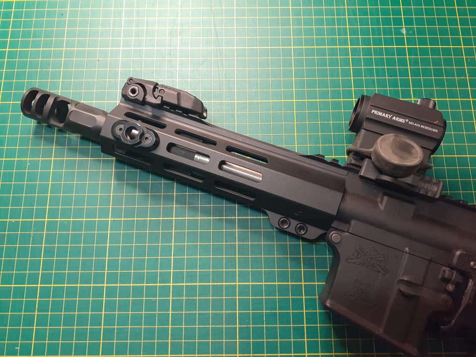

So I have this AR pistol with a 7" handguard. I want a red dot optic on it, as well as folding backup sights, plus QD sling mounts, and a light. The handguard is pretty small and there's not much room for me to get a good C-clamp grip that I like along with all of those other things. In this pic, you can see the front folding sight, and the QD mount, but I still have to find room for a WML.

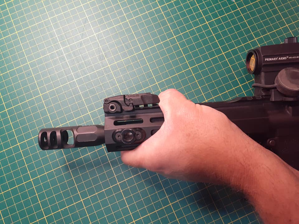

Here you can see with that with my fat hands and sausage fingers, there's no good spot to put a light anywhere. Not much on the other side either, let alone a pressure pad to activate it.

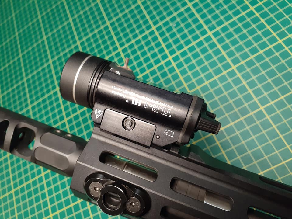

Now... I could put one of those TLR-1 lights on there but the only good spot for it is at the 12 O-clock position like this:
I actually really like that position since its ambidextrous, in perfect reach of my thumb, out of view of my red dot, and no need for a pressure switch, but then there's no front back up sight.

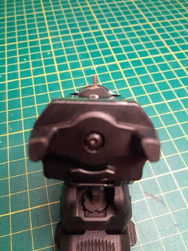

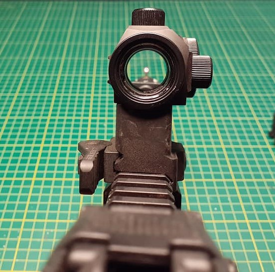

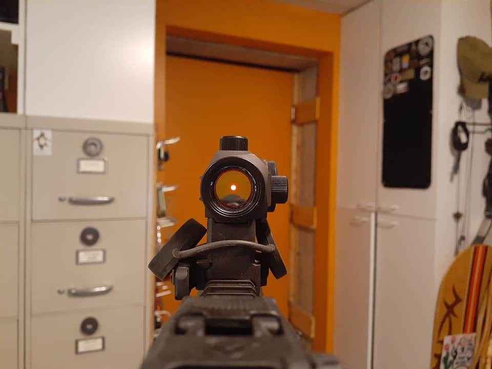

Here you can see how the light housing is barely visible through the optic:

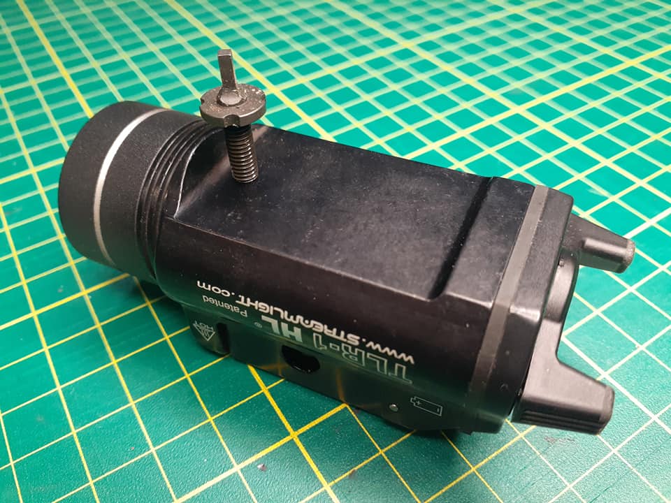

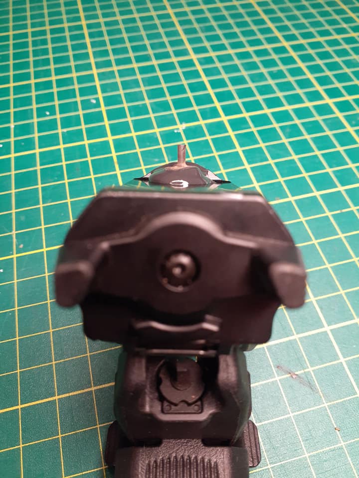

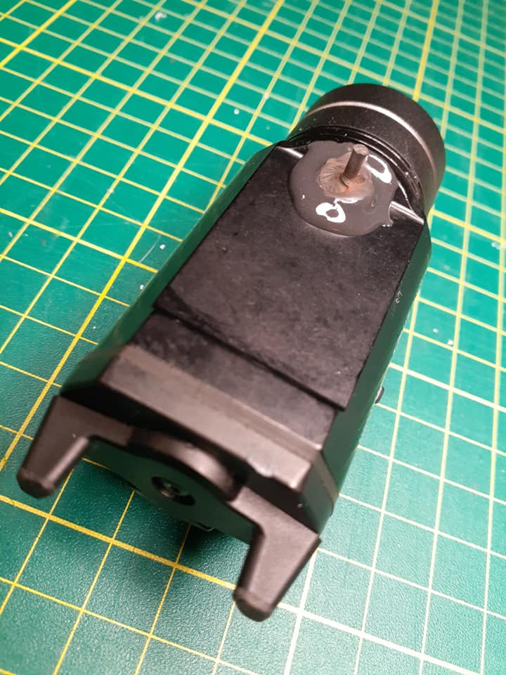

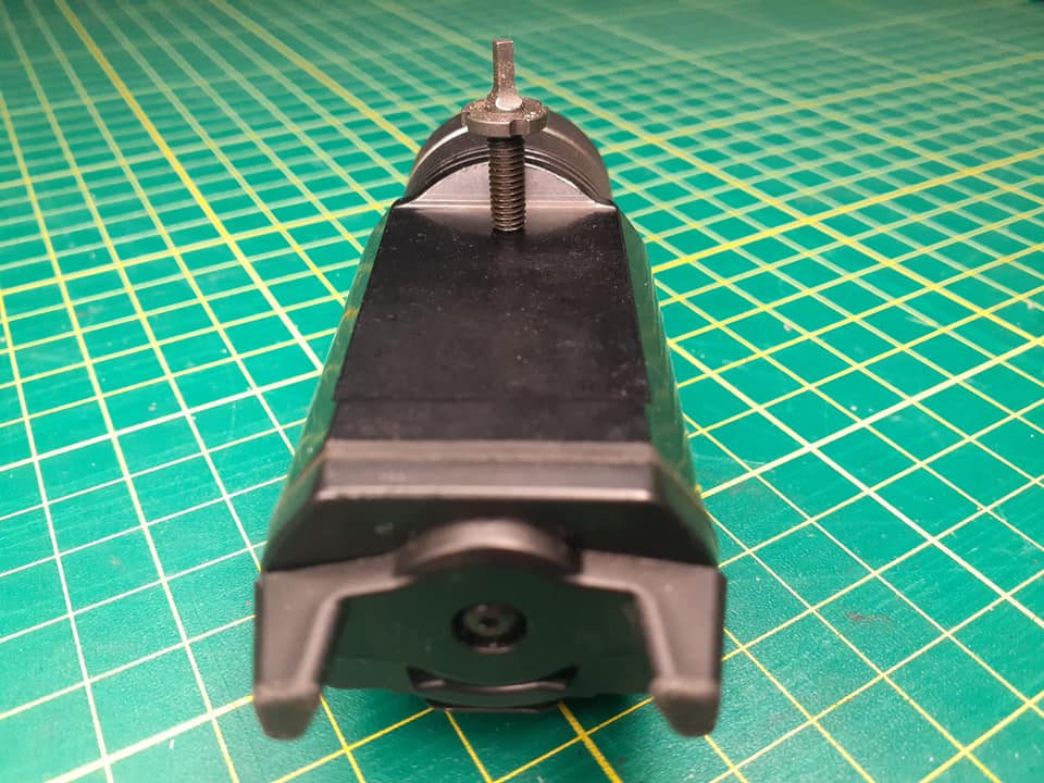

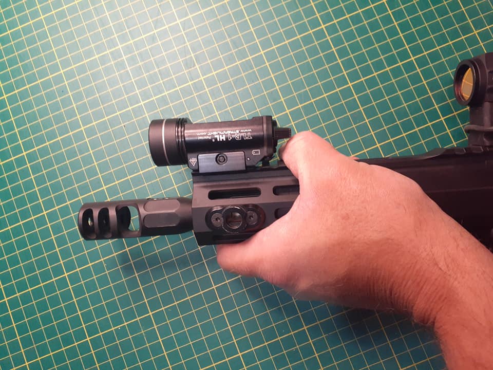

Last week when I emailed Streamlight about my idea for a WML/BUS, I told them I had a prototype built. They seemed interested enough that they emailed me back today and wanted to see a pic of it so I figured I'd better finish it up.
Rather than destroying an existing Magpul post, I just made one quick from a grade 8 bolt on the lathe, but I forgot to get pics. It basically looks like a thumbtack but the base of it is about 3/16" thick. I drilled a bunch of tiny holes in the face of the "thumbtack" and drilled a bunch of dimples into the aluminum on the TLR housing. I didn't drill through the aluminum, so when this thing falls off, all I need to do is dab some black paint onto those dimples and it's good to go, should still be watertight too.
I figured the dimples and holes will give more teeth for the JB Weld to grip onto. Yes I used JB Weld to attach it to the housing. I've had geat luck with JB Weld and many projects in my life, so I thought it should work fine for this project.
This will be a "file to sight in" type of post, hopefully if Streamlight decides to make something, they'll make it adjustable, but this should work for now. I left it plenty high and will file it down when I sight it in this week, but this is what I was looking for. We'll see how long it lasts... I used some cold blue on the post.
Here are some pics.

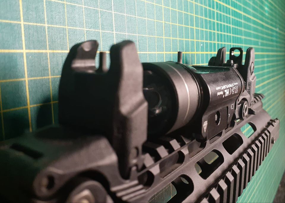

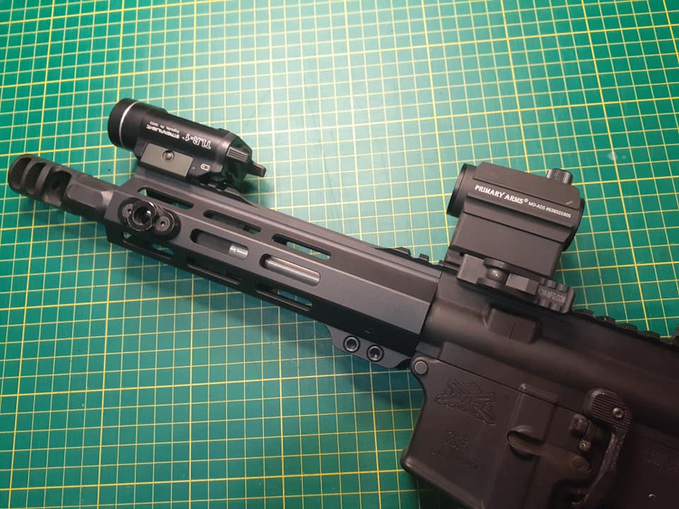

Here, I put a front and rear BUS and the light, on a separate rail so you can see how things line up. You can see I also need to file the "light sight" down just a bit, but I'll wait until I get to the range for that.
