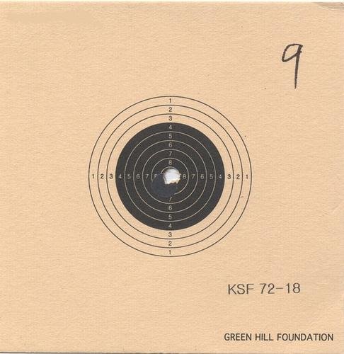

Postby Stradawhovious on Thu Dec 10, 2009 9:59 am
RAGGED wrote:And Goalie, when are we going to see your target posted!
I would bet you it looks something like this.......
Shot at 1000yds. Offhand. High wind. Midnight in December during a New Moon. Iron sights.
