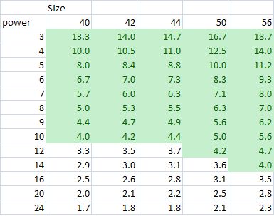

objective size divided by power. IE 50mm/14X is a 3.6 mm exit pupil. Full day light it won't be bad, but when you take into account low evening or day time it becomes a factor.
You want to try and stay above a 4mm exit pupil. The below chart gives you a good layout of which powers and objective sizes will get you in that range/ball park.

Postby bucktail on Sat Feb 27, 2010 9:06 pm
The size of the exit pupil that you want all depends on application. If the animal that you're hunting is crepuscular like a deer, then you want to optimize the scope for low light, and I'd want to be able to get 6mm exit pupil minimum. On a rifle for colony varmints, exit pupil is a non-factor. I have a 6-18X44 that is plenty bright at 18X during the day, even if it's cloudy. Lots of guys like 6-24X40's for prairie dogging which gives you an exit pupil of less than 2mm when set at 24X. I don't like a lot of magnification though. I'd been mostly open sights up until about 10 years ago, and I'm still not that good at target acquisition with them at high power. When it's hot you get mirage from the barrel heat at high magnification, and you lose field of view so that you can't see your hits, which takes part of the fun out of varmint shooting.
