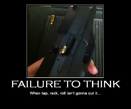

PRS wrote:haha alright I see it now! wtf...
This is like one of those "What is wrong with this picture" games.
Stradawhovious wrote:Just attach one of the pointy jags on a cleaning rod, stick it down the muzzle end of the barrel and tap on it until it comes out.
I'm kidding. Please don't anyone do that.
But if you do, video tape it.
Seismic Sam wrote:Yup - considering the fact that the 9mm is a TAPERED case (unlike a 40 or 45) shoving it in backwards would really jam in in the chamber good and hard. It's .345" wooden dowel time, provided you can field stip the gun.
Oh, and what was the reaction of the two dypshyte rocket scientists when they were told the mistake they had made?
Norsesmithy wrote:Not really, and if you are paranoid anyways, just dimple the center of the dowel with a drill bit.
Seismic Sam wrote:Yes, well good luck getting a 9mm - .010" piece of pipe unless you can make it up on your own lathe.
Holland&Holland wrote:Same issue with I am pretty sure same model on my last range duty day at Oakdale. We emptied the mag after we cleared it and reinserted it both ways. It was amazing how easy it inserted backwards.
