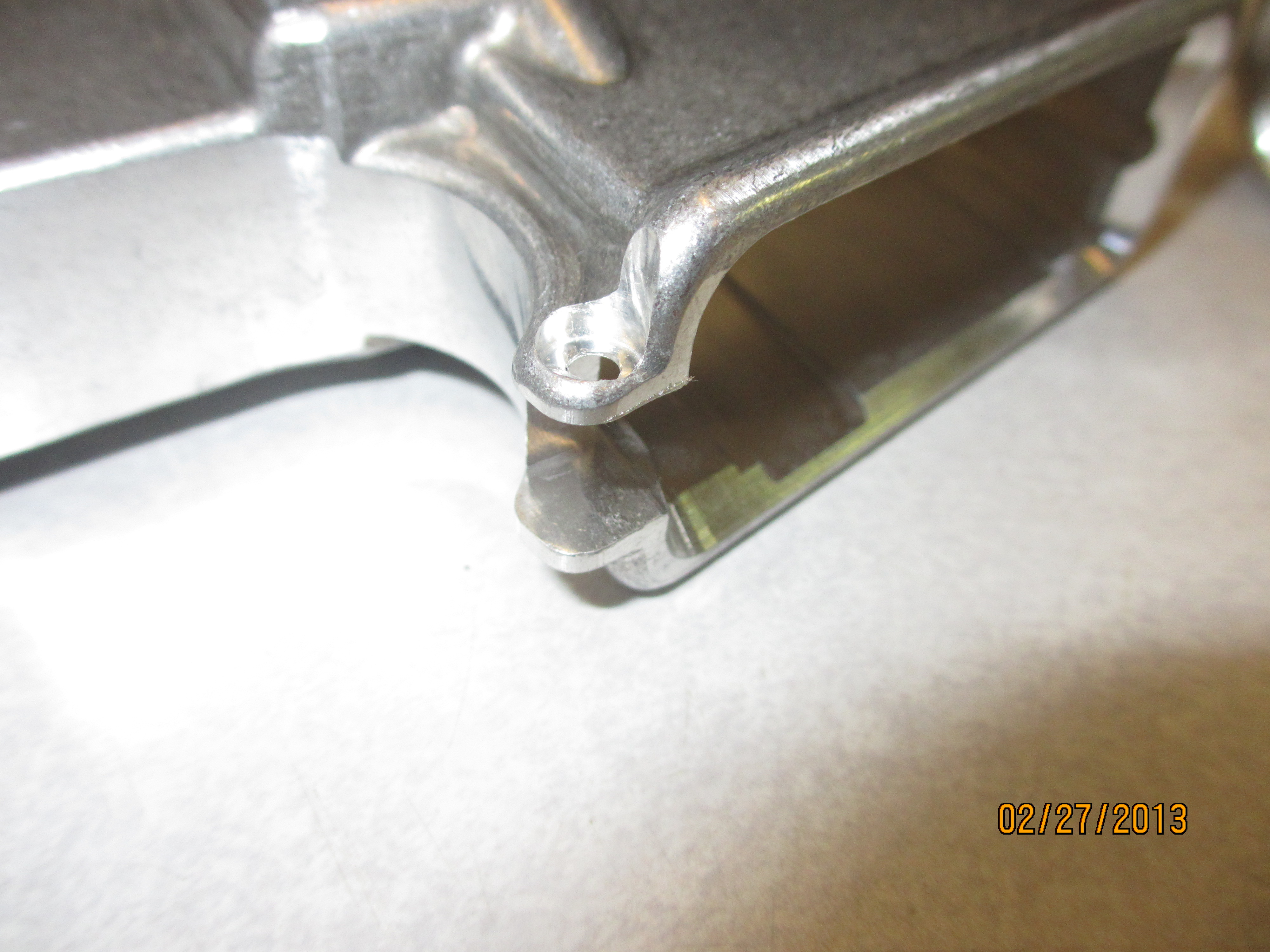

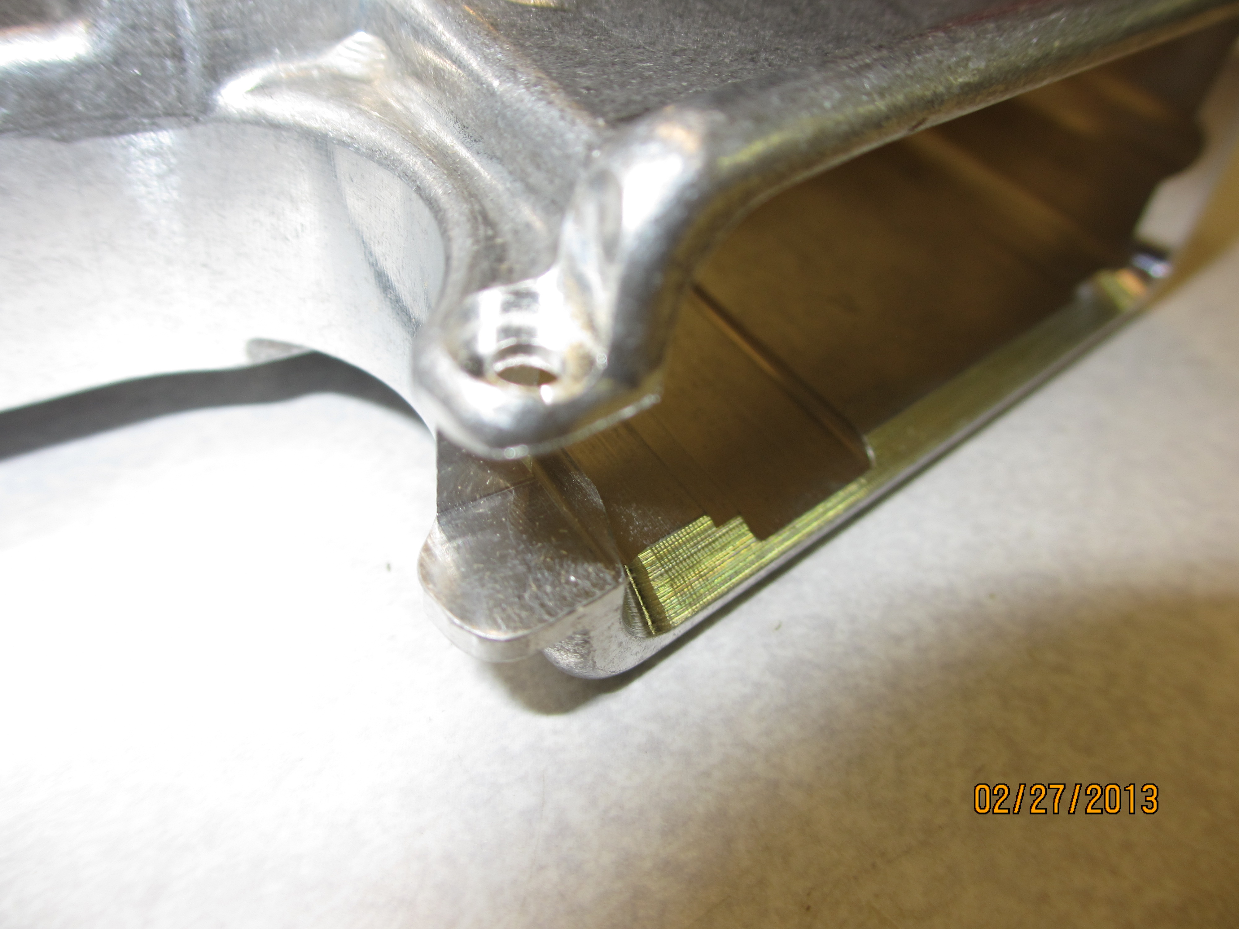

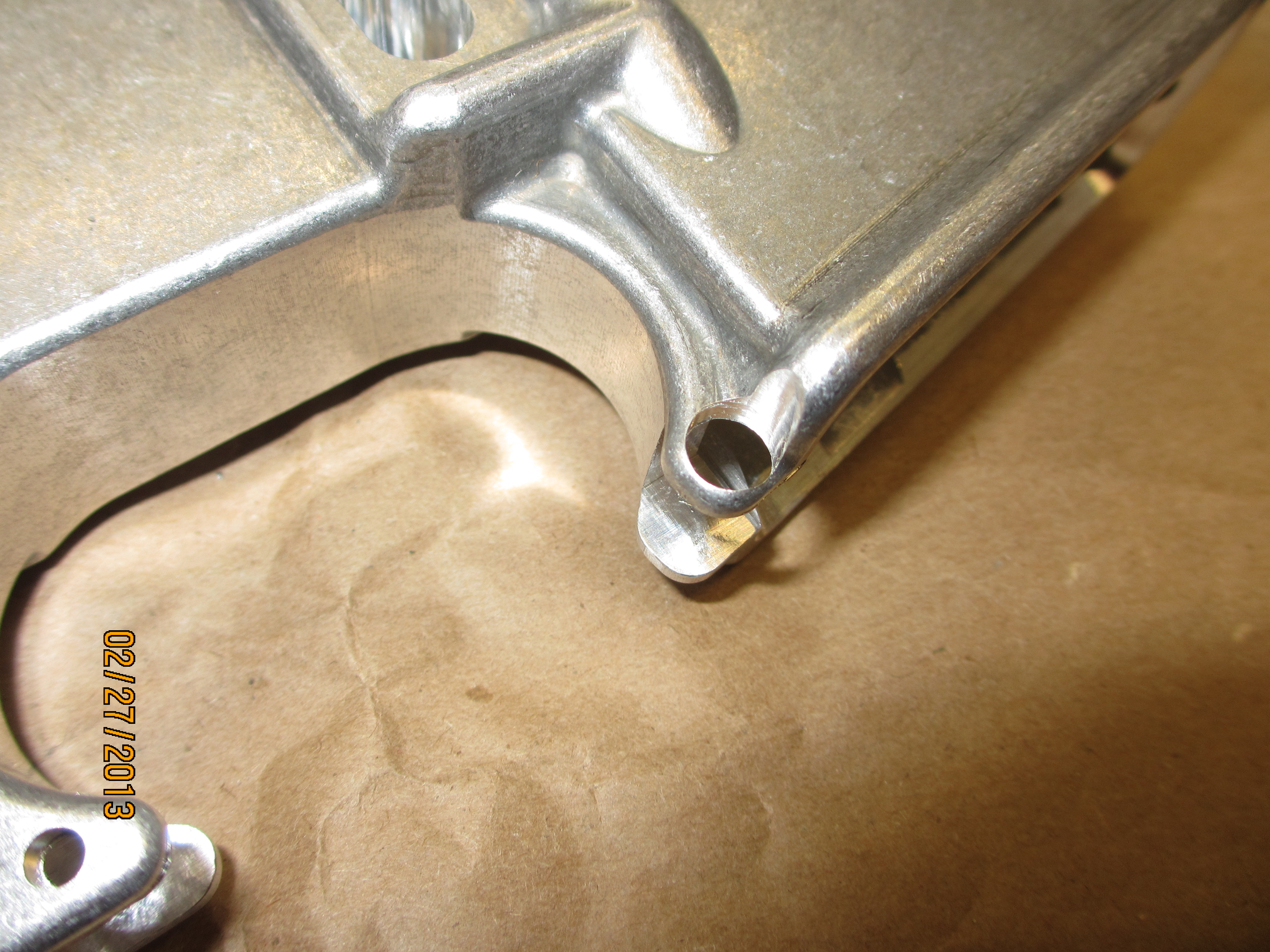

They shipped - got them on Friday - inspected them on Saturday and found the 18 of the 25 had a defect. I shipped them back today. The spot face for the trigger guard roll pin was machined way too deep - all the way thru on one of them. A good one should just have the material cleaned up on the forging - the tool had gone .050-.125 too deep into the forging. They are going to try and replace them later this week.....working on getting pics posted right now.

Postby jakl on Mon Mar 04, 2013 6:09 pm
pics

Re: JAKL Machine 80% Build Party
Postby jakl on Mon Mar 04, 2013 6:14 pm
all the way thru
Postby jakl on Mon Mar 04, 2013 6:16 pm
typical of all 18
