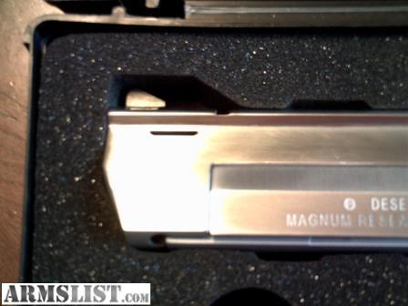

Postby Seismic Sam on Sun Feb 02, 2014 10:05 am
Here you go:
If you go to the Mag Research Q&A page, they even recommend Magna-port as the way to add a brake to their guns. There's no way you can equal their quality and precision, so the question you have to ask yourself is whether saving money for something inferior which may not look quite right is really worth it. For a $1200+ gun. that's really hard to justify. For a Mosin, who gives a s**t, but for a DE??
Re: Porting barrels
Postby FJ540 on Sun Feb 02, 2014 10:35 am
That's definitely sinker EDM, and you're not going to replicate that with a mill very easily either.

Postby FJ540 on Wed Feb 05, 2014 7:47 am
They might have wired those too. The funky edges made me think sinker but it could just be the photo.
