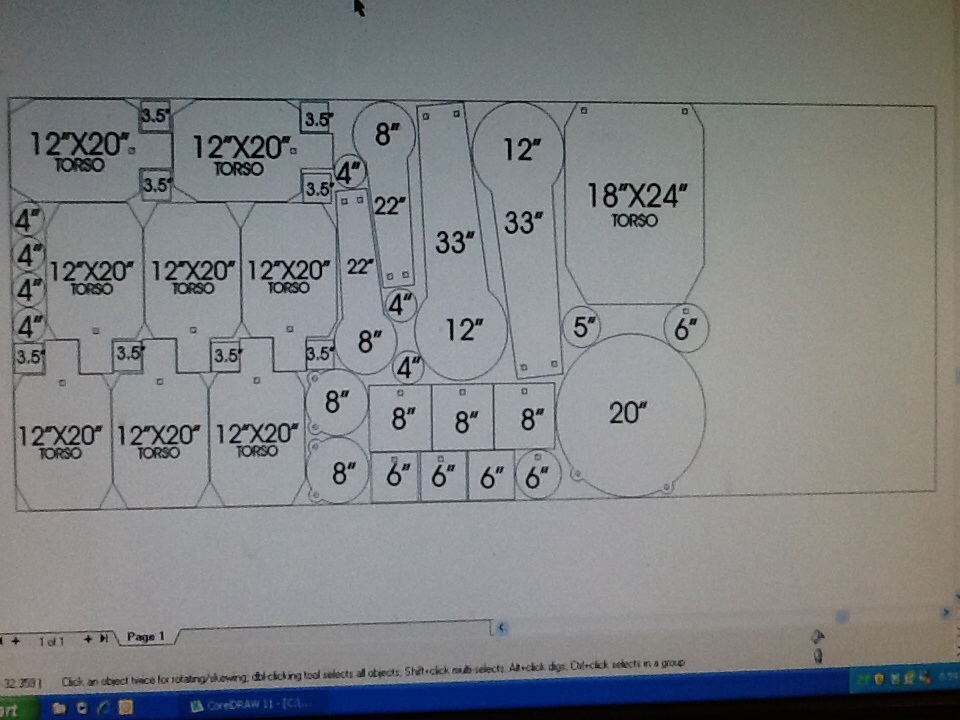

So this is what I'm planning...This is a 4' X 10' sheet. Not sure if I should cut holes in the 4" and smaller ones though. I could weld bases on them and use them for fallers. All holes will be 5/8" square and could be used for carriage bolts or shepards hook style hooks. What do you all think?
I'll still have a 48" X 31" piece left over for more targets... Or I could duct tape it to my chest for body armor, when I go to Walmart, I have gained a few pounds...
Posts: 2171 [View]

Yeah I've checked out those two places, and looked at a bunch of other target makers too. They all sell so many different shapes and sizes though. I understand it's really preference, and distance, but was hoping to get some ideas of what are more common at matches.

I know. The main reason I'm making these are to use up the steel.

I like the idea of the steel challenge courses and hadn't thought of that, thanks for that suggestion, not sure why I didn't think of it. I don't know if I can get another sheet at the same price I got though so I may have to hold off on those big rectangles.
