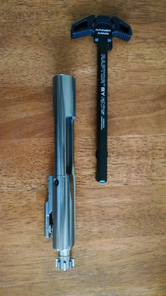

Postby unknown on Sun May 04, 2014 7:52 am
Whooo! I just need a handguard and gasblock to be all done. I guess ill need something to aim with... [attachment=-1]uploadfromtaptalk1399211548532.jpg[/attachment]

Re: Growing an ar15
Postby FJ540 on Sun May 04, 2014 1:13 pm
It really depends what you want to use it for. I personally don't like quad rails, because they're uncomfortable and heavier than a less encumbering free floated tube. You generally need to add rail covers to make them non-painful, which adds even more weight that otherwise doesn't need to be there.
Full length top rails are all the rage now, but those aren't even needed since we can't use night vision here anyway (what else besides a back up sight on the very front are you going to put up there?), and you don't want to bridge the gap with your optic mount either.

Postby Hmac on Sun May 04, 2014 2:21 pm
unknown wrote:I got a couple new parts in the mail. I think the next large purchase would be the hand guard. I havent researched much about hand guards yet, do you have any advise/recommendations?
Thank you!
I was all quad rails. They're ok, but kind of bulky and kind of heavy. I recently pulled my DD Lite rail off an SBR and replaced it with a tubular rail (Noveske NSR). The smaller diameter and lighter weight are extremely noticeable and extremely useful. IMHO, best way to go. BCM KMR, Geissele, Noveske appear to be leading the race. Nothing magic about keymod IMHO, but there are a lot of attachments hitting the market. Gear Sector is another tubular rail to be watching for. Tubular rails in particular require a low-profile gas block. Make sure your barrel is at least dimpled for it, and preferably (IMHO) get the gas block pinned. One good solution to pinning your gas block is the one you can do yourself from 87 Industries.

Re: Growing an ar15
Postby UnaStamus on Mon May 05, 2014 12:02 am
Keymod is the future of rails for the military, and this is already being implemented with contracts from KAC/KMC. This translates into commercial and LE proliferation. Rails are still going to be relevant, but other proprietary slot-mounting systems are not going to reach the level of popularity that Keymod will. There are numerous accessories out for Keymod, and there are even more coming out every month.
I have been running a BCM KMR13 rail for a little while and it's an outstanding handguard. The thing is ridiculously light since it's made of a magnesium alloy. My 16" with KMR13 13" rail and lightweight profile DD barrel is lighter than my 11.5" SBR with a 10" railed Daniel Defense AR15 LITE 10.0 Rail.
As HMAC pointed out, several companies like Noveske, KAC, BCM, Fortis, Geissele, Midwest Industries, and others have Keymod options. More are on the way.
My 11.5" is getting a BCM KMR10 in the near future. I'm loving the smaller radius and lighter weight.

Postby unknown on Thu May 08, 2014 9:08 pm
I had the opportunity to handle the BCM rail, unbelievably light.
For now, I think the next purchase will be a Fortis Low Profile Gas Block http://fortismfg.com/ar15-fortis-low-profile-gas-block

Re: Growing an ar15
Postby Ghost on Fri May 09, 2014 10:12 pm
The Midwest industries keymod is a good rail for a good price and Midway has a discount on them now. Also if you haven't done it the 4mm set screw mod is easy for the detent on the takedown pin, 4mm setscrews can be located at Ace in Lakeville. I don't want to link to another forum but a little googlefu and you can find it.
