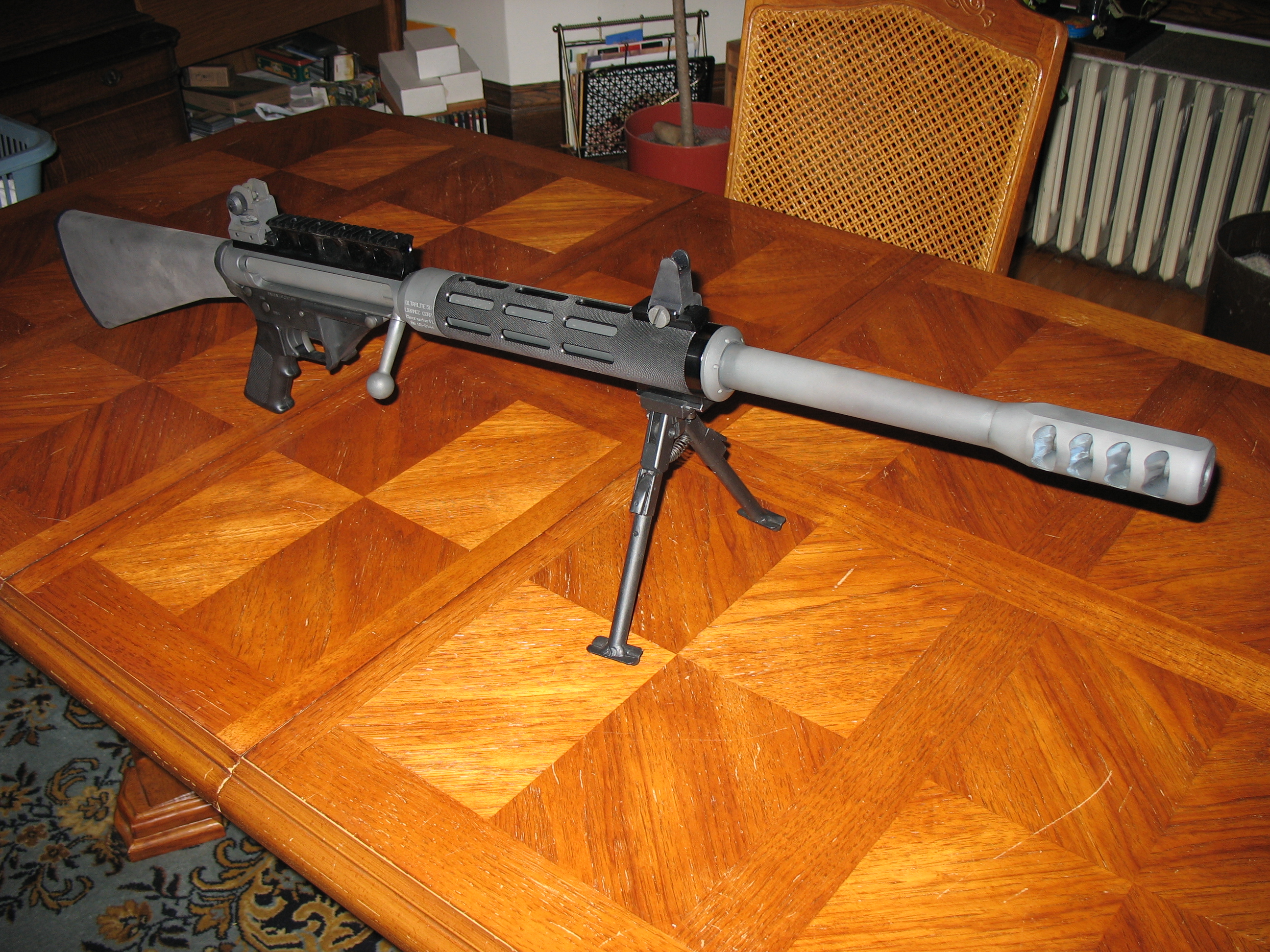

A few years ago a put together a 50 BMG rifle using a DPMS single shot lower and an Ultralite 50 (now Tactilite) 18" upper, with open sights mounted on the rail. It was my 50 BMG plinker!
As built it was only 14.5 lbs and had that hard rubber butt plate. It was a bit abusive even with it's good muzzle brake. I added 2 lbs of lead to the hollow part of the stock and added a Limbsaver butt pad which brought it up to a bit over 16.5 lbs. At that weight it was a pussycat to shoot, with no more than the recoil of a 3" 12 ga. The blast from the brake was impressive but it was a great gun to shoot. I may have to put another together just to use the 1,200 rounds of ammo I still have.
