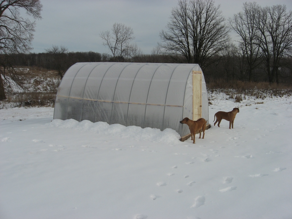

I built my DW a greenhouse for her chickens earlier in the fall and decided I needed one too. Finished up as the snowflakes were flying.

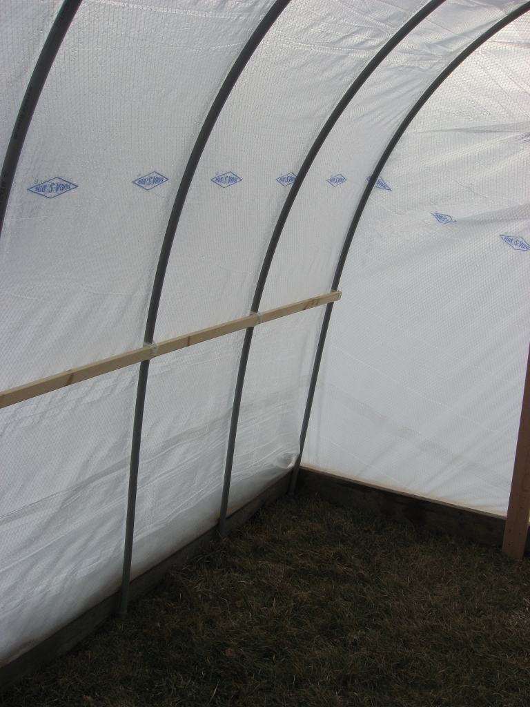

I drove rebar stakes in the ground to anchor the ends of the PVC conduit hoops, threw together the end walls, tied it all together with duct tape, and stretched plastic over it. I probably have $60 in it.

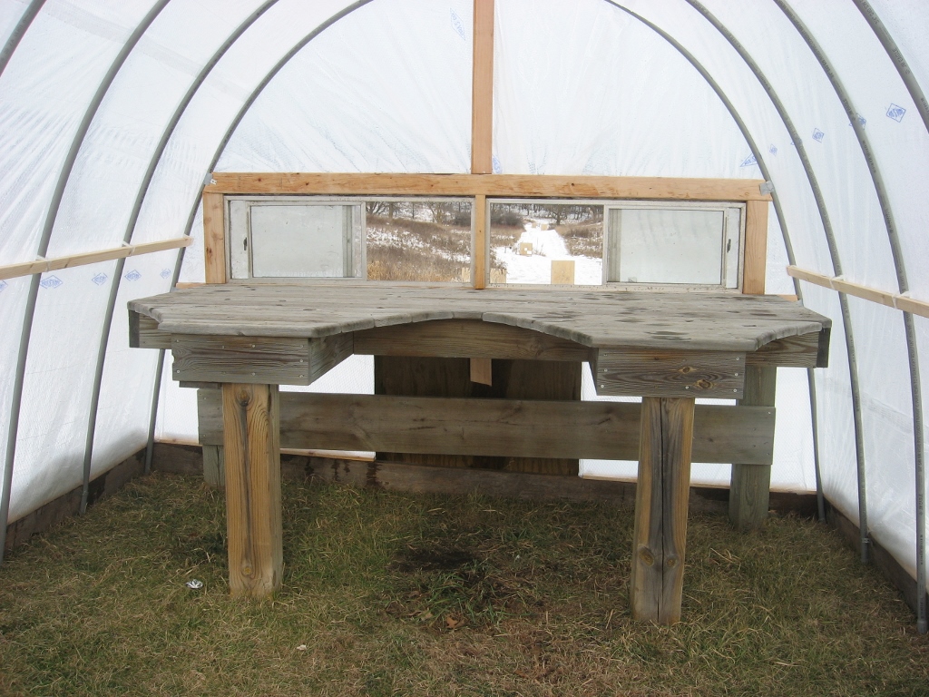

So what the hell is this doing in the gun forum? Spring, summer, and fall get busy and I never seem to get my load development done. Not much fun trying to shoot groups when you're shivering. So the greenhouse house sits over my shooting bench.

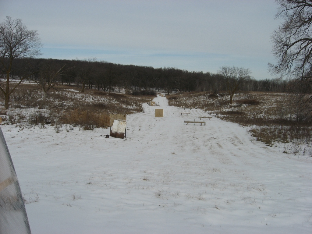

Here's the range, target stands at 25, 50, 100, 200, and 300.

If plastic was put on with two layers, a small fan blowing air between the layers adds insulation effect and lets the sun heat up the interior and keeps it that way longer. It also allows for the snow to slide off more easily.
Nice setup.

Thanks guys. My DW's greenhouse has been in the mid 70's so far when the sun is out. That's with some chicken body heat but it's got a vent too. It'll be interesting to see how it works. Backup heat is available.

I just used 1 layer of plastic. Hopefully as the temps and humidity drop it will be less of a problem.
