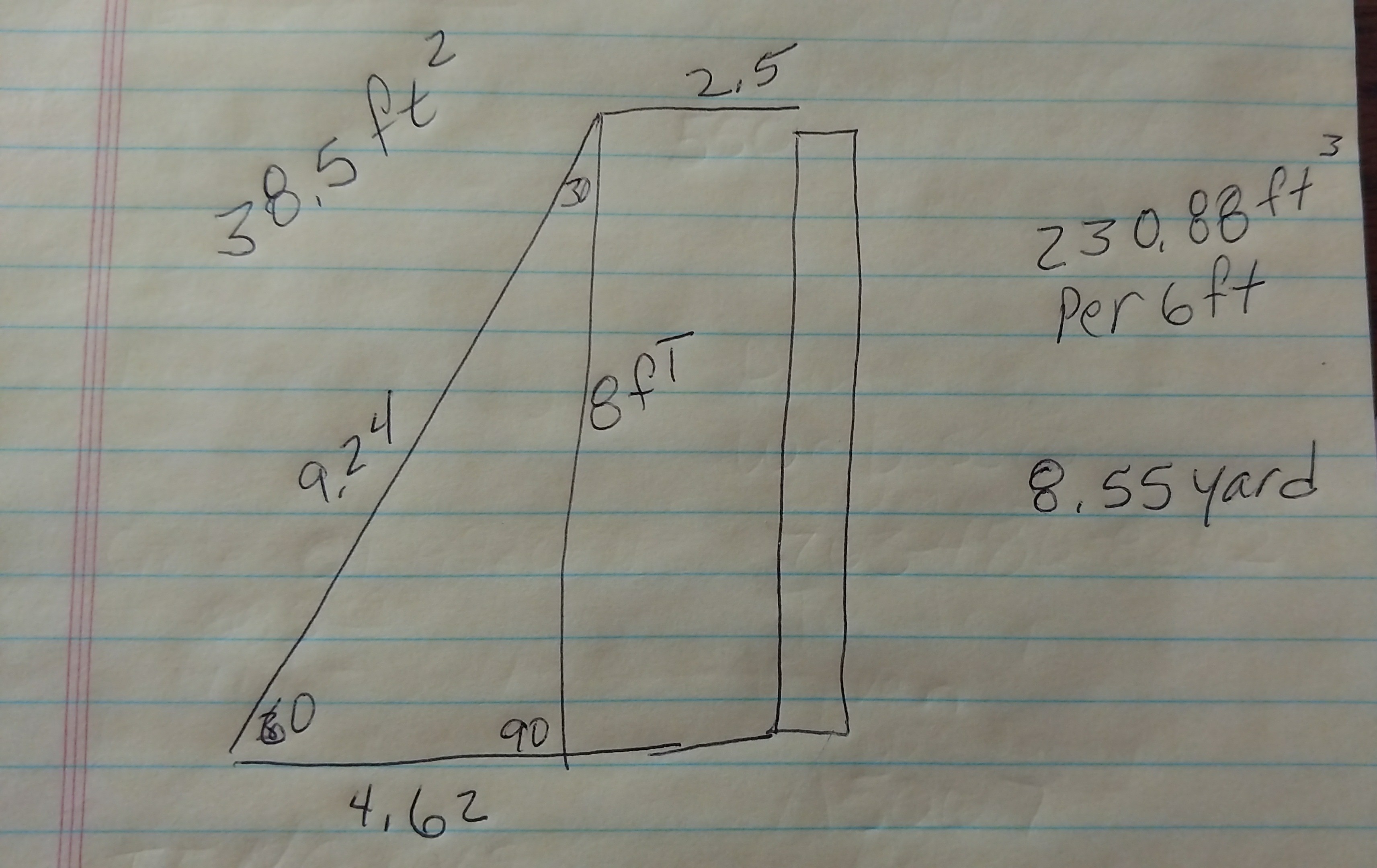

seen backstops made from Cattle feeders made of wood and fronted with dirt. Stack like 4 on top of themselves. Allows for less dirt needed.
Likewise, you could use 4X4 or 6x6 post set at 4-6 foot widths, putting 2X8 up at 45* angle and spacing 12" apart. Front with 24-30" of dirt at thinnest.
May want to consider a slight 10-15° angle forward on the 4x4 to prevent pushing back.
At 8.5 yards, that's about a 70' wide berm.

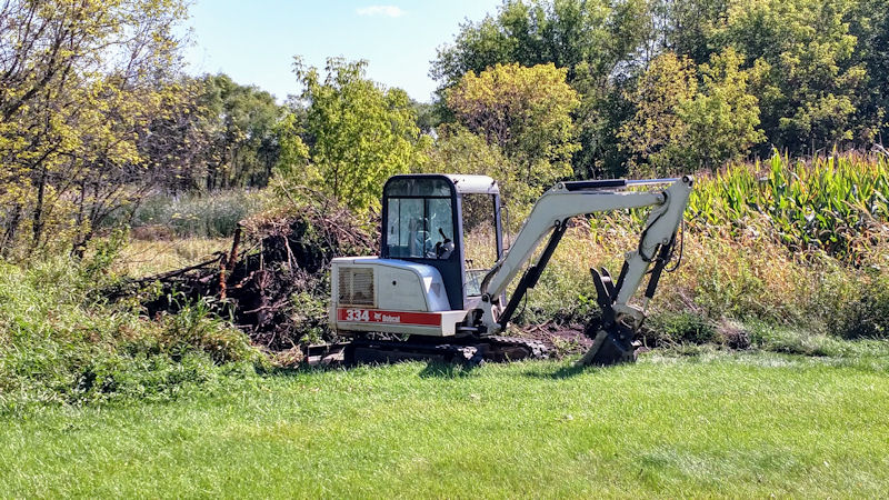

Hehehehehehe
Fun to operate too. It can be had for $250 a weekend. Rather powerful little item too. Got it from my local bobcat dealer though.

I got a few hundred yards of sand dug out of my 1/16 acre pond in 16 hours using a Cat 305 mini-ex. If you're good with equipment and have the work ethic, you can get a lot done with smaller machines. I never did verify how deep my pond got, but I can tell you it's melting the snow in the middle of it when the ground around it is not. It might not be freezing to the bottom like I expected it did. Sometime this summer I need to take a swim and find out. When I was digging it, I was below the ground water table, so I was working blind the whole time.
Like Jon says - you might be surprised how reasonable the big toys are to rent. It'll cost you several hundred dollars for delivery/return via semi, but the weekly rates on a D6 are still only like $1200.
