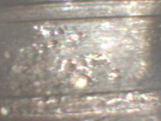

After about 500 rodding with CLP and brush, decided its time to get out the bore scope. Take a look at the pitting. Should I rebarrel this old gem? Its in the middle of the barrel.

Postby Erud on Sat Jan 22, 2022 4:01 pm
How does it shoot?
Re: Cleaning a rusty barrel
Postby crbutler on Sat Jan 22, 2022 7:43 pm
+1
If it shoots ok, it’s fine.

Postby Bearcatrp on Sat Jan 22, 2022 8:42 pm
Have no idea how it shoots. This rifle has been sitting a long time. Wanted to clean it up before trying. Can’t believe how much powder residue I’m still getting out of it. Will have to wait until spring to test it out.

I wouldn’t do anything with it until you shoot it. If it shoots well, I wouldn’t do anything. Borescopes are good at determining what a barrel looks like, but bad at determining how well one will shoot.

Per your borescope photo, no need to do anymore cleaning until you shoot it. You did a good job getting the rust out.
While it might lead a bit easier than a Virgin bore, if it shoots well, don’t mess with lining it.
If it’s mostly in the middle of the barrel, you might be surprised… I’ve seen more issues with damage at the muzzle end causing inaccuracy than elsewhere.
It’s also a reasonably cheap rimfire… if you can hit a golf ball at 30 yards with it, I don’t know how much better sleeving or rebarreling will get you.
Have reasonable expectations.
