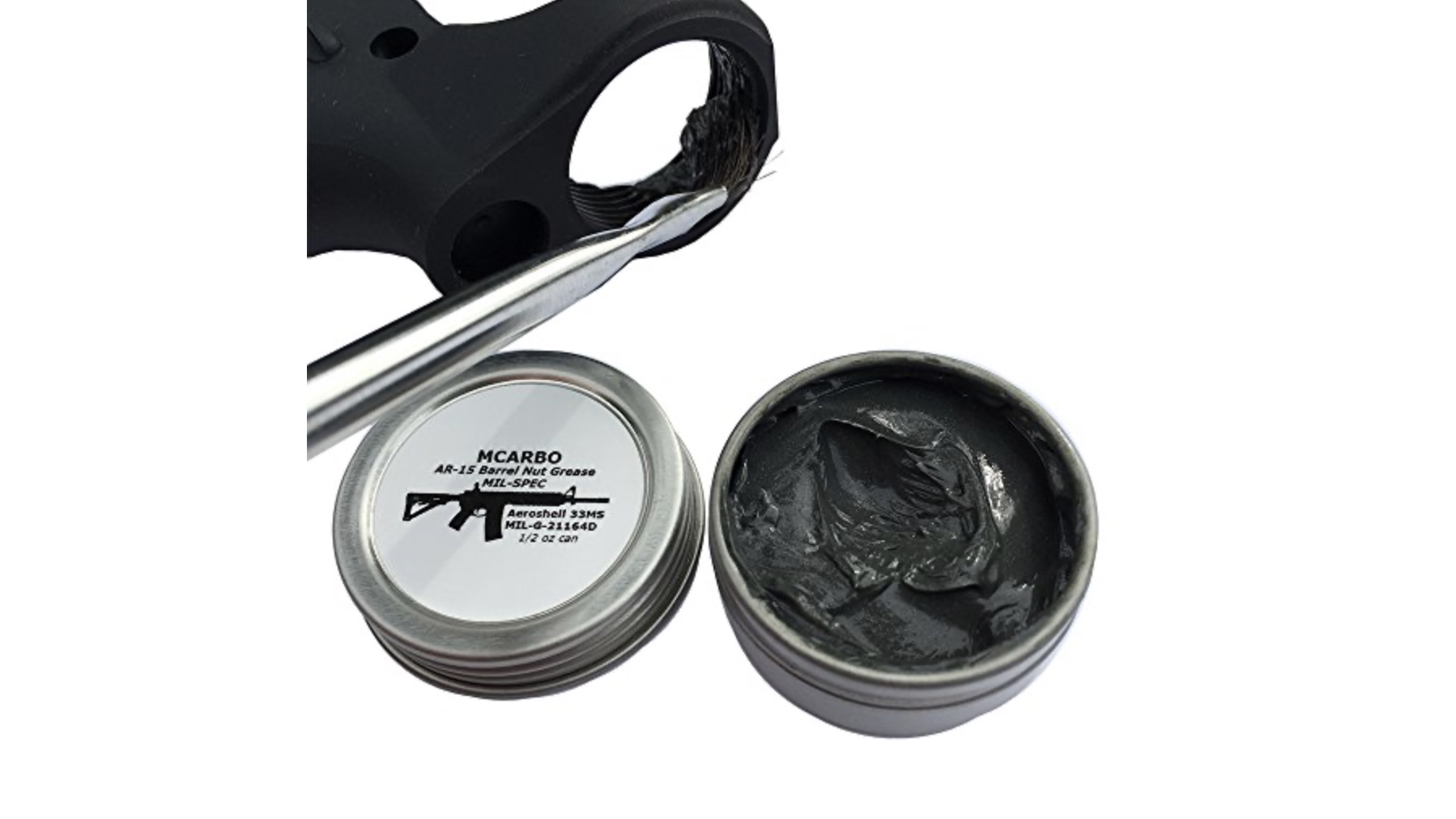

Postby Uffdaphil on Tue Feb 06, 2024 1:32 pm
Don’t forget the Aeroshell or equivalent hi-temp grease for the barrel extension. And a heat gun for the receiver if a tight fit.
I would have an experienced person do the swap unless you plan on doing future installs. Torque values are important for the barrel and muzzle device. Gas block and gas tube alignment is critical. Loktite needed for gas block. Best would be someone who would let you watch and explain the process. I am comfortable doing my own work, but would never do someone else's barrel install except for family.
Grease for barrel extension? Will probably have someone put it together since I have never assembled one before. Used to buying complete uppers. Decided to keep the current upper I’m using now, which is a 12.5 inch barrel. Once I get all the parts in, which will be a few months, I’ll have someone put it together.
