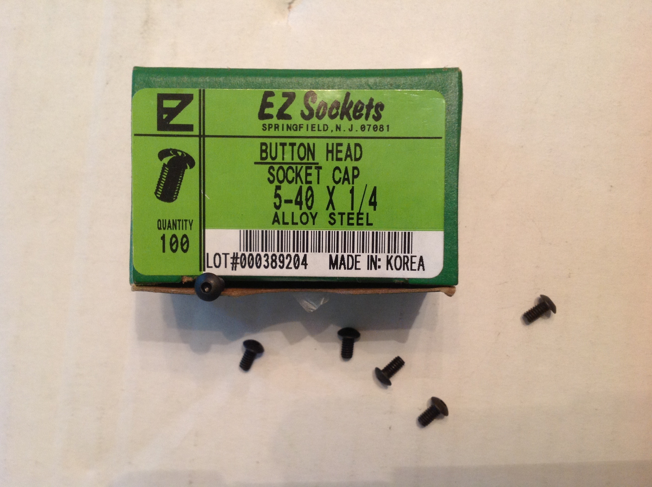

I replace the rotten Magpul rear trigger guard screws with these socket heads. Cheap, fit tight, and I prefer the looks. Use a small rubber/nylon washer if you wish. I usually don't bother
